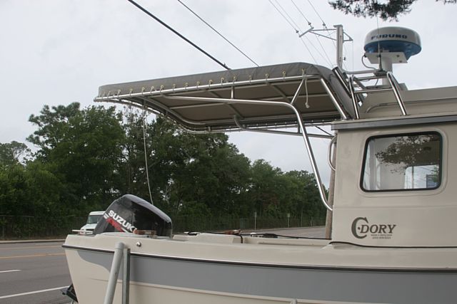

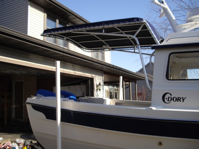

For anyone wanting to see Brazo's extended roof, here it is:

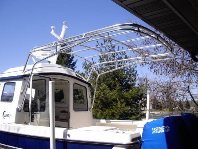

and the frame:

Nice job, Robert!

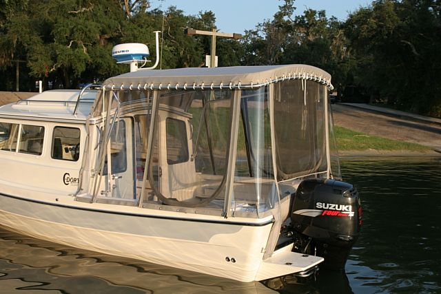

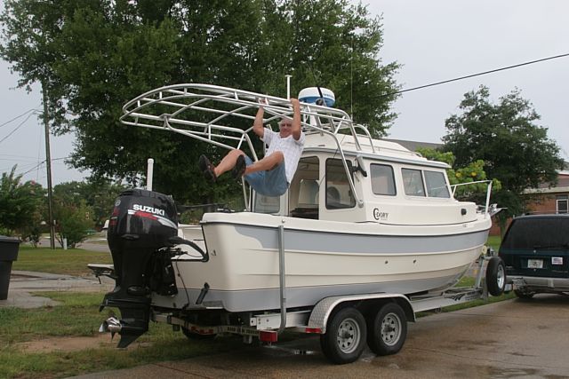

And here's the same view of Roger's (Flrockytop):
and the frame:
and the entire enclosure;

Nice work, Roger!
