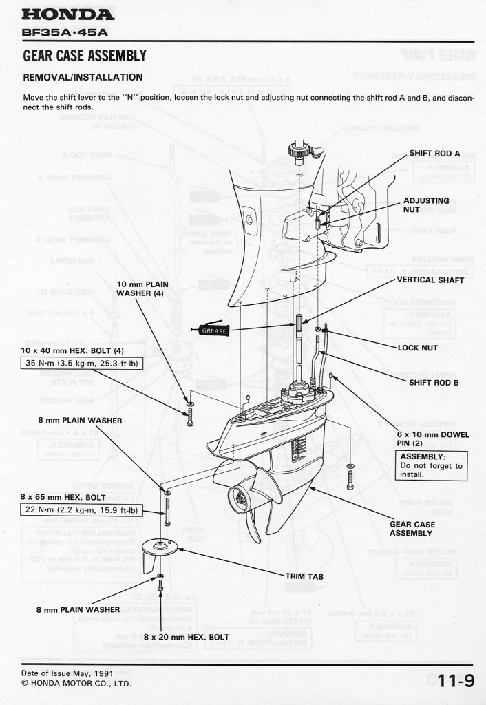

Gary, there is a rubber bushing between the outside hub of the prop and the inner splined hole. That is there to cushion things and to "let go" if you hit something so you won't break a drive shaft or worse.
When it lets go, the engine would react as you described. It indicates a "spun" prop as it is called. If you remove the prop, nut/cotter pin and pull it off, it should become obvious.
Not sure if that is repairable or not, probably not.
Btw, does the motor sound like it's going into gear? You can usually feel that in the shift lever. If not, there's a rod that runs from the lower unit up to the power head that has some lock nuts on it. if that has loosend, you can shift without the lower unit engaging. If you had those impellers changed lately, it could have been not tightened by the mechanic.
Here's the picture from the outboards pictures section. You can clearly see the shift rod, the lock nut and the adjusting nut on the right hand side. YOU DO NOT HAVE TO TAKE ANYTHING APART TO SEE THIS, IT'S OUTSIDE THE CASING. If it's not a spun prop, this is surely the cause. Let us know what you find. This makes a good case for twins or at least a kicker. I had twin 45's on my CD 22 and of course twins on my TC255 now.

Thanks so much for the advice and great detail diagram. I'm going to take the boat out of the water in the next day or two (didn't have the tow vehicle with me yesterday), and I'll begin investigating per your suggestions.

Well, I ended up being able to get out to the marina this evening, and, sure enough, it turned out that the shifting rod had come loose. Apparently when the mechanic at Guenther's Marine changed the impellers, he did not tighten it properly and it soon worked its way loose. Not a comforting thought as to his competence.
Thanks to all of you, especially Charile and Roger, I knew right where to look and was able to attach and tighen the adjusting nuts. It was shifting into gear again, and the prop performed well in a short run.
