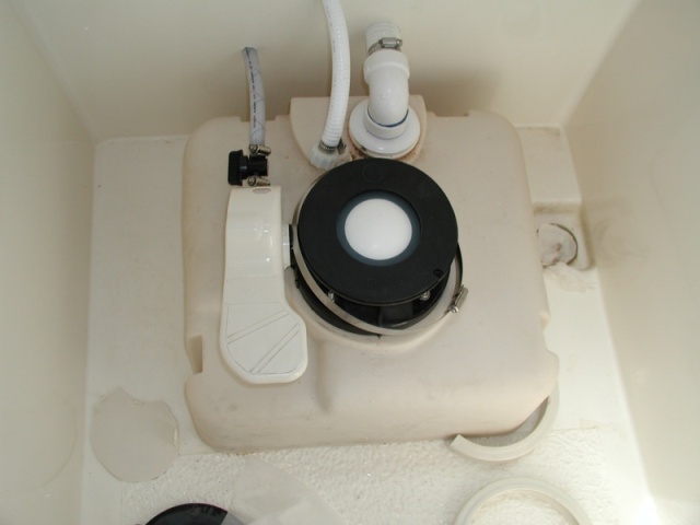

Here's a tip I got from Jim on Wild Blue. While you're putzing around with the plumbing at the head, install an on/off valve in the inlet hose. This will save some of that precious fresh water.
There are just times that you don't need additional water when you flush Wink In the photo, the bowl has been removed for maintenance and you can clearly see the valve location. Good luck with the leaks.
