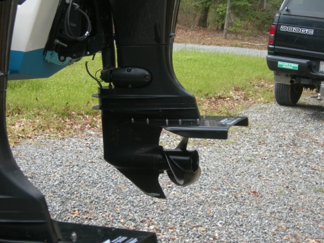

I have had the sport SE on Litl' Tug for about a month now and I really notice the difference with it. Pluses to me include cosmetic (it matches Yamaha color exactly), ease of installation, less profile to walk around when the boat is in my driveway, cost.
It's "disadvantage" to me is that it can't be used as a step as people say the permatrim can, though I'm not sure I'd feel good about that anyway. Just from the feel of the plastic and past experience with lawn tools and kids toys made out of this kind of plastic, I do think that it will have a life span being subjected to water and sun, but with the cost and ease of replaceplacement, I am not too worried. I think I'll get many engine hours out if before it dies.
