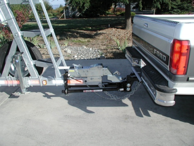

This type, the Equal-I-Zer, works with surge brakes as the bars slide fore and aft throught the hanging brackets. Apparently the chain type like the EazLift don't work well. We have since changed to electric over hydraulic but the surge brakes did work as they were supposed to with this set up.

I am also using an equalizer brand hitch, and it works fine with surge brakes. You cannot use the sway damper attatchment.
Also there are DIFFERENT SIZE spring bars which have to be co-ordinated for the tongue weight. For example for the c Dory 25 I use 700 lb bars and for the Tom Cat 1000 lb rated bars.

You can buy these direct from the factory and they are very helpful. However, you can get a better deal from a dealer. The factory charges full-bore retail. One feature that meant as much to us as the load distribution was sway control. They really dampen any sway through their design. The factory will send you a video, no charge.
