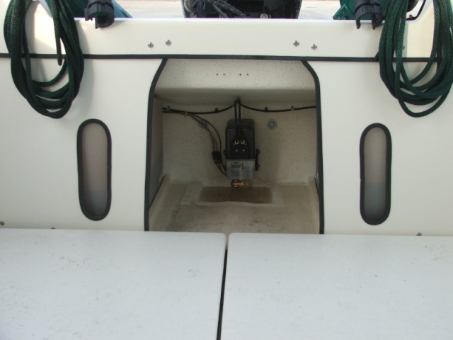

Here's where the factory installed the pump for our Bennett M120's.
You'll love them. As Tyboo Mike says, it's as if they're made for the CD22.
