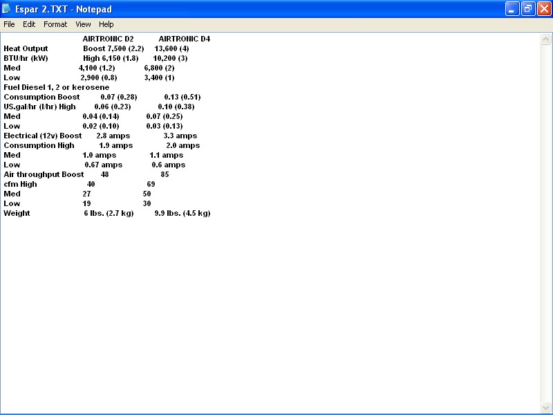

Airtronic D2 Heater by Espar

I'm interested in the "real world" current draw.
Is the low setting sufficient ?
My Wallas draws .55 amps.
It looks like there's not much difference in draw between the D2 and the D4.
Pete
