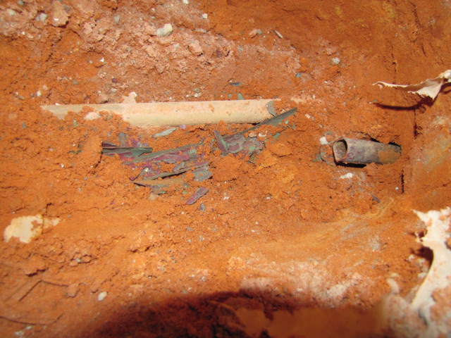

Several days ago I noted a warm area of the utility room floor. Yesterday evening: no hot water or water pressure. We shut off the hot water and this AM "American Leak Detectors" pinpointed the leak ($285 right where it was hot several days ago).
The plumber was here for about 4 hours, and the 3/4 inch soft copper hot water pipe buried 6" under the 5" re-inforced slab is completely shot. It looks like bark peeling off a tree. The house is only 8 years old. The cold water pipe is fine. We are going to have to replumb the entire hot water system--through the atic. This is a 3600 sq foot 4 bath house, with some ceilings as high as 16 feet, so not an easy job. But that is life.
The plumber thinks it was a lightning strike. I think perhaps some form of electrolysis. Any thoughts:

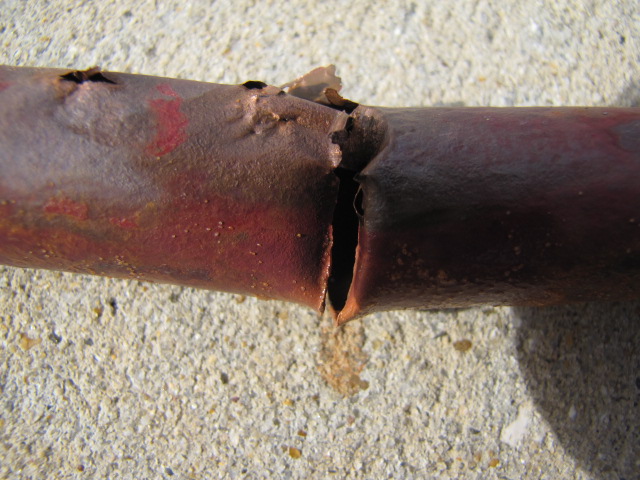

To answer some questions: Gas waterheater. Home owners does not cover. No anode on the external lines from the heater. Heater is 8 years old, original. There is no AC or DC voltage or current from the hot water pipe in the ground or at the water heater to house ground, to ground rod and to the cold water pipe measured with a sensitive DVM.
We will be replumbing with flexable plastic through the attic. The problem is that we have to trust the 1/2" cppper pipe to the sink, since it is in essence on an Island (access from the ceiling is almost impossiable.
The hole in the pipe was on the bottom. The exfoliation of the layers of pipe were external. The bore of the pipe is clean and no corrosion. There was no debris or particlulate matter in the water heater when drained.
Hole in the pipe:

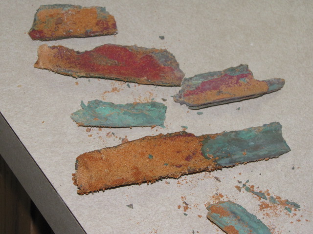

The lot is on a sand peninsula. 6 feet of sand was removed, and 12 feet of "Red dirt" from Alabama was put on the lot, impacted and allowed to settle for 3 years before bulding the house. This dirt is high in iron content, I am not sure about other minerals, but it is not from salt water areas.
Here is a photo of the pipe end and the material which exfoliated from it in the "red dirt".
The intact pipe is the cold water pipe and there is absolutely no evidence of corrosion.
