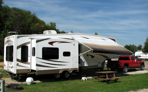

Warren, here's a photo from one of our posts that shows the VuQube in the lower left corner...
Small by RV standards, but what are you willing to give up in your TC to have room for it?
