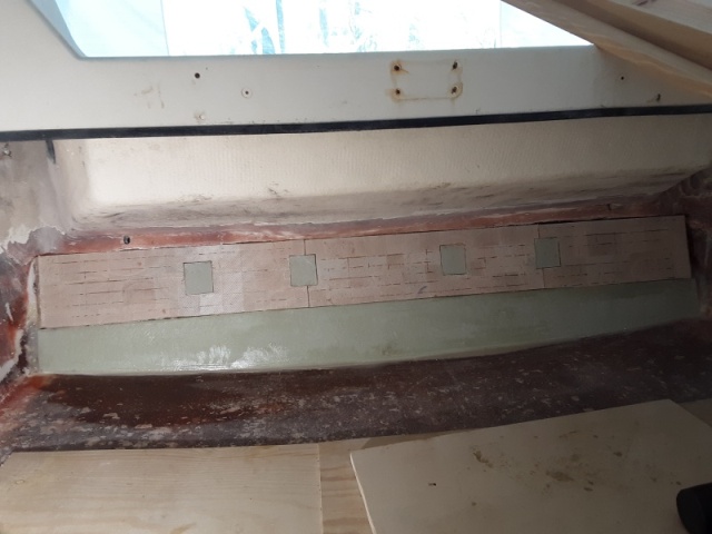

Put the coring in the transom today. Two layers, with solid chunks of glass at the outboard motor mount bolt holes.

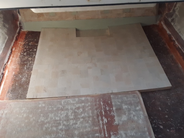

Today got the core bonded in the middle of the cockpit area, including the sump. Decided to do this in smaller sections to make it easier. I used 1/2 core under the sump and made it a little bigger than original. I plan to put 2 bilge pumps here when done. This seemed to go pretty well. Really helps to have somebody mixing epoxy for you when doing large areas. Only smaller sections left so I should be able to work even without a helper.

Yay! Finished laying the balsa into the hull today! Soon I will be done with the repairs and on to the upgrades!

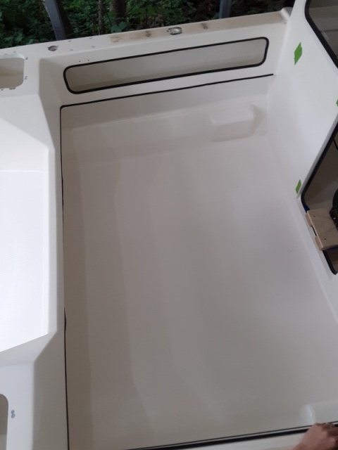

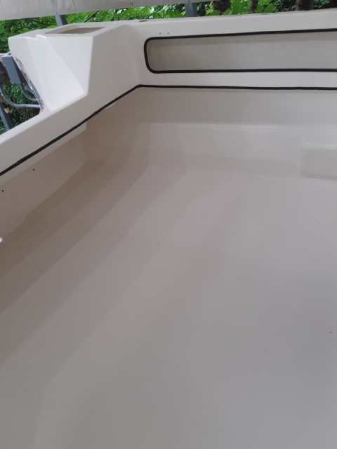

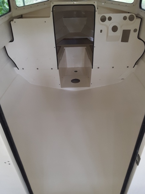

Okay, still behind on photos in the album, but here are some from today. The hull repairs are completely done. I just need to bottom paint and then its going back on the trailer. Of course then I will still need to put ALL THE PARTS BACK IN! We leave for florida in 3 WEEKS!
So I painted the walls in the cabin and the cockpit, and in the v-berth storage. The floor is all gelcoat, and I am really happy with how it turned out. I cannot see any of the repairs.
I will update the album with captions when I get time. It may not be until after we get back from vacay.

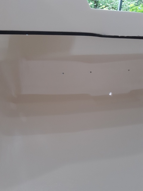

I'm putting the rubrail back on tomorrow. Was planning to use butyl tape to seal it. Think this is okay? I'm going to use ss machine screws with lock washers and nuts.

Personally, I would use flat washers and fibernuts and forget the lock washers. I'd also run a bead of sealant along the top and bottom edge where the rail meets the hull.
PostPosted: Fri Jun 18, 2021 12:57 pm    Post subject: Reply with quote
When I redid the rubrail on Journey On, the original pop-rivets were corroded away, stainless mixed with aluminum.
Anyway, where I could reach the inside, I used 1/4 panhead machine bolts with a plastic washer on the outside and a locknut on the inside, with plenty of 5200 as sealer. This requires 2 people. Where I couldn't reach behind, I used sheet metal screws.
Also, opposed to sealing water from entering the rubrail, I drilled drain holes to let the water out. This seems reasonable since the rubrail wasn't corroded. Also, the joint is sealed with epoxy filler and doesn't leak unless the hull is breached. And that's really serious.

I normally use locknuts on everything, but in this case I wanted to be able to spin the nut on freely by hand when drilling all the holes. I agree with journeyon that the rail should not be caulked. It was originally, and water was always trapped in there. Whenever I jacked the tounge of the trailer up water would run out the back of the rubrail, even when the baot hadn't been wet in a long time.
The admiral just helped me drill all the holes. I started near the back just ahead of the bend at the aft corner. Drilled a hole and then put in a screw and had her on the inside putting on the nuts. Worked our way around a few holes at a time to make sure we didn't get any buckles in the rail. Drilled all the holes but didn't put fasteners in all of them. Then pulled the rail back off and will now put butly tape tape over the holes and reinstall for real this time. I got a washer that has a rubber washer bonded to it to keep the ss machine screw off the aluminum. I think this will be a permanent solution.

This repair took about 7 months. Perhaps it could have been done much quicker. Much of the time I spent drying core. Also, I feel that I went a little overboard, as I like things to be just right. I rebuilt all the cabinets, rewired the entire boat, ran new gas lines, new plumbing lines and components, relocated batteries, installed the propane locker, patched all holes in the hull and roof, wetsanded the entire boat and buffed and waxed, and sanded off the bottompaint and reapplied. I never would have gotten this done in time without help from the cbrats. Thanks to everybody who gave advice during this project. I'm hoping that these photos will help somebody in the future if they find themselves in the same situation. Always happy to answer any questions.
