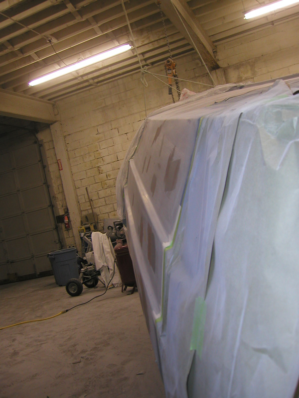

Some sanding to do then one or two more spray on coats to fill the pin-holes, more sanding and we should be ready for the gelcoat.
More photos in my album.

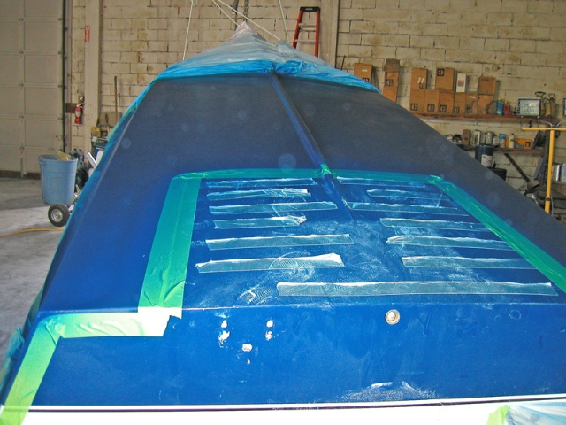

Question: the tape on the bottom in photos 49 &50 - just for grip when standing there?
Jim – that is what it is for. When we are sanding the bottom of the hull, there is dust/grit produced and it ends up under us. When we push up on a sanding stroke, we would end up pushing ourselves off the boat. The tape helps hold us in place.

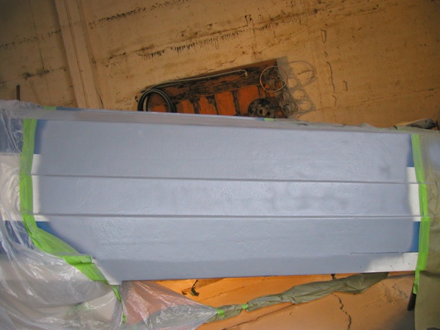

We are ready for the first coat of gel coat after a light sanding in the morning.
It is amazing on the amount of dust produced in this process. 80 feet on the other side of the shop even has a coating of dust.

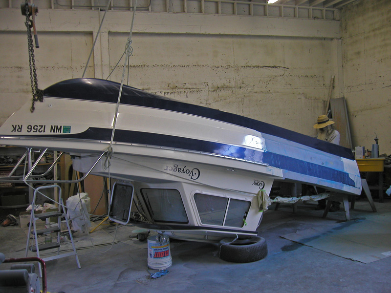

The first coat of gelcoat went on last night.
I am really getting antsy about getting the boat upright, so I can start on the inside. I figure I will miss the Poulsbo get-to-gather, but I do not want to miss the Cathlamet get-to-gather also.

So far I have not met many of my goals. I am way behind schedule, but the most important goal has been met. That is the quality of workmanship.
In order to make the addition imperceptible, we will have to add a few scratches on the bottom to match the front of the boat, where I have scratched it from running up on the beach.
Tomorrow we will roll it back over.
