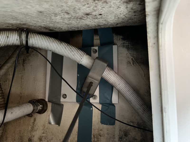

This first one shows the PVC board I used 4000 to glue it to the inside of the hull. You can see the machine screws I mounted from the back that the inverter will slide onto.

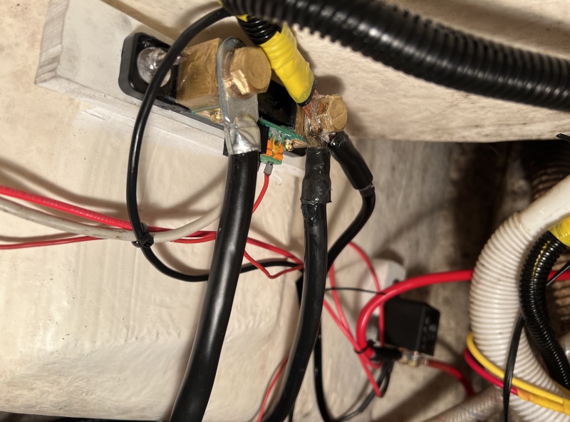

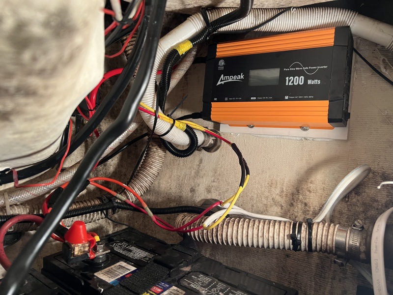

The next photo shows the inverter in position. Also shows the Victron Battery Monitor Shunt. I moved that over from the starboard side so it would be closer to the house batteries, and allow for a shorter inverter negative cable run.
This next photo is just a close up of my shunt

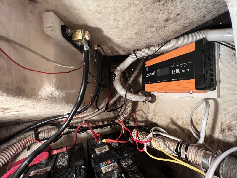

And the final photo is of most everything in the back completed.
The white triplex wire at the bottom right corner of that last photo, is the 12/3 that will carry the power into the cabin. I'll put a regular plug on the end (hanging down below the bilge hose) that triplex, to plug into any of the three inverter outlets. I'll get some photos later of the cabin receptacles later to upload. In the third photo, bottom right, you can just make out the 200 amp relay that turns the inverter on and off. The switching wire for that runs up the starboard side to my helm switch panel, where I'm using the old macerator switch. Colby

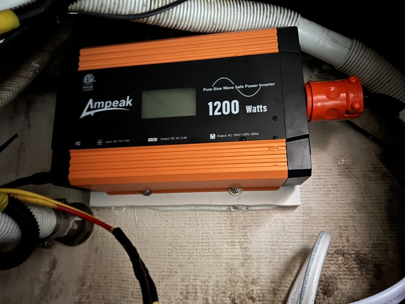

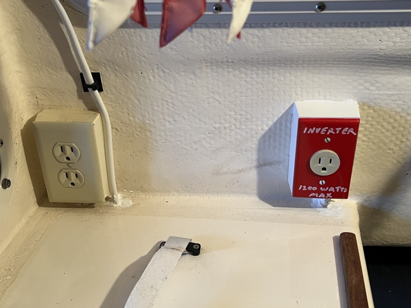

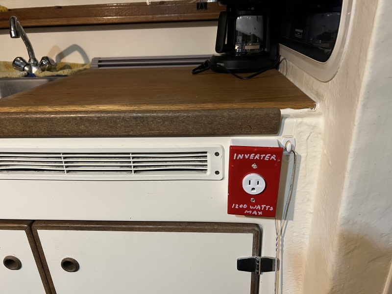

My inverter install project finished up.
The plug on the microwave shelf.
Inverter with cabin cable plugged in.
Galley plug

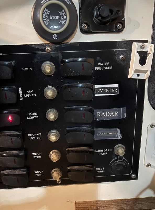

Helm switch panel.
Hey Harvey (Sleepy C), if you are reading this, see my new install just above the switch panel? Wink
