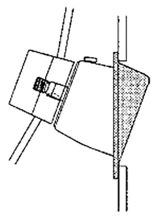

I think now that I will most likely go with the Bay Star system, however the one thing I still kind of "want" from the Sea Star system is the tilt helm. Not because I tend to actively tilt wheels, but more because I'm not very tall, and so if I set up the (fixed) Bay Star helm and the boat seat up where it's comfortable for me, it would likely not work for anyone else (friends who come along, etc.) - I think they wouldn't be able to get their legs under it. That might be an issue.
I think I'll look into an idea I read earlier in the thread, which is could one use the Sea Star tilt helm with the Bay Star system? I may find out that the different line types (or some other reason) precludes it, but.... I've got at least all of January to consider the options so why not.
Another option might be the Teleflex H5419 "wedge" discussed above.... perhaps I will call Teleflex to see if it can be used with Bay Star (it says Sea Star but it sounds like sometimes things can be adapted if a person wants to figure it out).
Edit: I found an older thread wherein someone did install this with their Bay Star helm. See here if interested:
http://www.c-brats.com/viewtopic.php?t=11748&sid=44dae8bed6b2eceff42e1a5f600a4ab6

Sunbeam - you can find it here on the manufacturer's site .
PostPosted: Fri Jan 10, 2014 7:41 pm    Post subject: Reply with quote
Thanks, Roger. You know (and somewhat embarrassingly), I think I may have seen this at some point in the past before I was "serious" about upgrading my steering. I think I thought it looked like it was going to project super far into the helm area (see photo below.... if all of that is aft of the helm "wall"...?) and decided maybe it wasn't so slick.
However, now that I *am* serious about upgrading the helm, and have all of the information from this thread, I will contact Teleflex and find out just exactly how that Bay Star tilt fits in practice. I think if it really does project that far (i.e. both sections aft of the bulkhead) it would be too much in my 22, which would put me back to either the Sea Star tilt helm (does not project very far - see photos in Kerri-On's album) or that angled/set-in "fixed" bracket for the Bay Star that I illustrated just above.

PostPosted: Sat Jan 11, 2014 12:38 pm    Post subject: Reply with quote
Hi,
In regards to the helm in the photo:
The part that's on the helm side of the bulkhead is about the same size as the normal BayStar helm. It contains the tilt mechanism, which is covered by the rubber bellows.
The part that's on the berth side of the bulkhead is the helm pump, it mates right up to the backside of the helm console and then the tilt mechanism is connected to the projecting shaft on the front side of the helm console (front side faces the helm seat).
So, yes, in essence you have the helm behind the dash and something just about the same size on the front of the dash.
That said, the version shown in the photo isn't different than the version used on Kerri-On in dimension. That is the distance from the front side (helm side) of the dash to the wheel is the same with either model, and the helm pump behind the dash is the same in both models.
Basically, there are three models of tilt mechanisms available: 1) Classic Tilt, 2) Sport Tilt Plus, and 3) Sport tilt. The actual mechanism is the same in each case, the thing that changes is the look of the housing that hides the tilt mechanism.
The one on Kerri-On is the Classic Tilt (square mount on the dash) and isn't available on the BayStar system. The Sport Tilt Plus looks just like the Classic Tilt but has a round mounting bezel. Both the Classic Tilt and Sport Tilt Plus use hard molded housings. The Sport Tilt model uses the bellows.
The Sort Tilt Plus and the Sport Tilt are available for the BayStar system. Here is a link (I hope that works) for the installation manual for the helms:
http://www.seastarsolutions.com/wp-content/uploads/2011/03/765703C.pdf
Les
PostPosted: Sat Jan 11, 2014 2:40 pm    Post subject: Reply with quote
Once again your information is so very helpful. Thanks for taking the time to explain it. From the look of the photo (because that section that you confirmed is forward of the bulkhead looks like the part that is aft of the bulkhead on the non-tilt, at least to my inexperienced eye) and the various names (Tilt, Sport Tilt, etc.), plus knowing that some things can be made to work with either system even though they don't officially promote it.... well, I was thoroughly confused as to what my options were!
Now I'm squared away and can make a decision, thanks to you taking the time to clarify things. Thank you so much! (And thanks to Joe for writing to you; I didn't want to "bother" you but I'm glad Joe did Very Happy)
For others following along, here is a photo of Kerri-On's wheel/helm area - that's a Sea Star system with a Classic Tilt (I now know).
