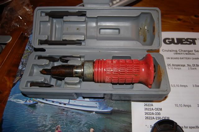

A Hammer Driver is the ticket. They sell them at Harbor Freight for about 10 bucks. I think Sears has them also. If you aren't familiar with a Hammer Driver it's a heavy spring loaded screwdriver. You put the screwdriver tip in the slot and tap the back of the driver lightly with a hammer. When struck the spring causes the tip to turn. The blow of the hammer keeps the tip from slipping. most are 3/8 drive and have interchangeable tips you can use sockets with also.

[ Here's a Hammer Driver.
