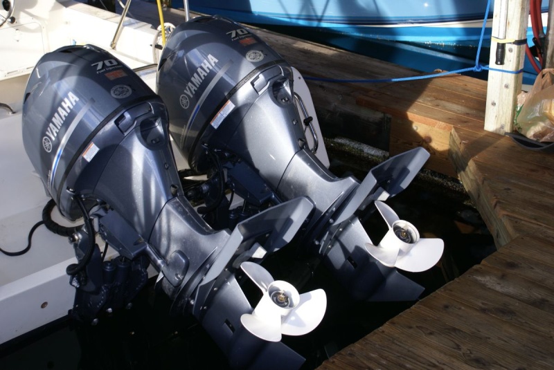

I wonder what twin 70 hp yammis would be like - pretty sure you could even plane on just one. It's an interesting thought.
They would be like heaven.
I had them on a 23 as replacements for the original Yamaha F50's. The 23 is heavier than the 22 to begin with, and I generally used the boat heavily laden for long range cruises, so it was marginal planning on one engine. That said, with the 70's I had a couple more mph at top end, and better mileage at best cruise (22-24 mph) with lower rpm.
I think the weight was comparable (maybe a little less) than a single 150 with a 8-10 hp kicker.
Anyway, I absolutely loved them. I would guess you could plane a 22 with one of these, especially with a little prop experimentation, unless the boat were really heavily loaded.

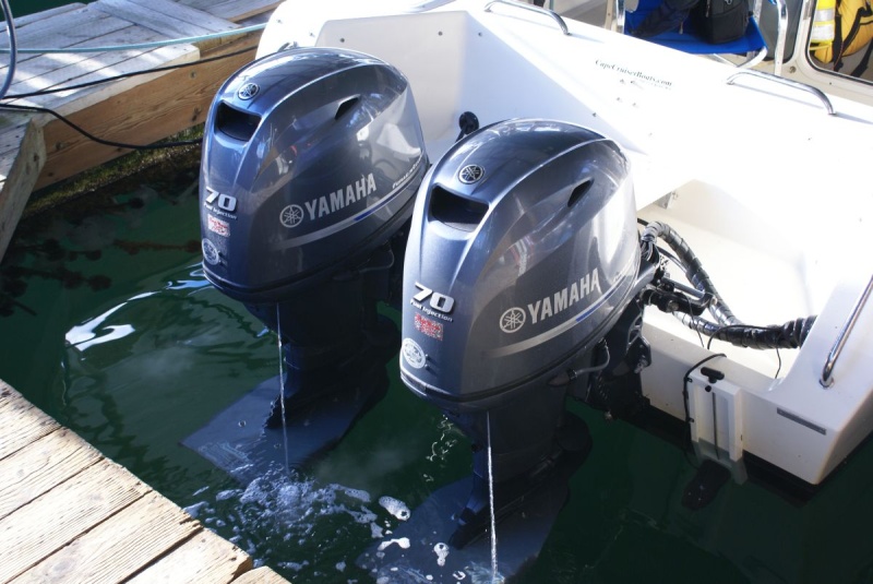

WeekiTiki wrote:
Off topic but for what reason is the 23 transom so much lower?
Here's another view. The Venture has a full-height splashwell. The forward wall of the splashwell is the same height as the gunwales. The 22 C-Dory has a cut-out in the middle of the splashwell.

WeekiTiki wrote:
I'd think there'd be water intrusion through the self bailing port
I assume you know it's just the splashwell that is "self-bailing," not the cockpit. At any rate, water intrusion into the splashwell is certainly not a problem. Not enough water could accumulate in there to put the ports below the waterline. I worried about lots of things in more than 6,000 miles up and down the Inside Passage. The splashwell was not one of them.

I think twin 70s yammis would be great on a 22 for some people. They only weigh a handful of pounds more than the twin Honda setup. The thing about the 22 is it cruises along great when conditions allow well into the upper 20s and low 30s when lightly loaded. The boat does very well in these conditions.
Then loading comes into play and if you go very heavy, like many of us do, and use the boat like the cruiser it is designed to be, bringing everything you think you might need because you're going to the middle of the wilderness, then your "cruise" is now full throttle and only like 22 mph. That's fast enough for many people, but when you have a lot of water to cover, the difference between 16-20 mph (don't like running full throttle) and about 25-30 mph, which I'm sure you could with twin 70s, can become hours.
