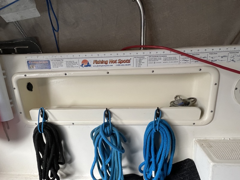

Two years ago, I replaced the starboard cockpit box on C-Traveler with a new one. The old one had many of the edge screw holes cracked or chipped out. Broken from over tightening screws, or from pulling the box out with the sealant that they were initially put in with! (Now days they just use some weather stripping material.) I kept the old one thinking maybe some day I would repair it. Or try to... Well, during our deep freeze a few weeks ago I thought it would make a good inside project, so I got that old box back out. I had recently seen a post on facebook in the C-Dory group where somebody used some epoxy and chopped up fiberglass. So I got some marine epoxy, and chopped up some fiberglass cloth. Ground out some of the cracked areas, then used the epoxy mix to repair the box. After some sanding and painting, I don't think it came out half bad. Wish I would have taken both before and after photos. The port side box had a few cracks in it as well, so after I repaired the old starboard side box, I replaced the port side with it. If you look closely, you can see the repair along the top left side is a little rough. Consider that a good chunk of the edge was completely missing there. But the rest of the box came out pretty good. BTW, I used some PVC board to replace that lower rail inside the box. I could have just used the one in the old box, but wanted to have this one completely done before replacing it into the boat. Colby
Looks really good! I like your dockline holders!

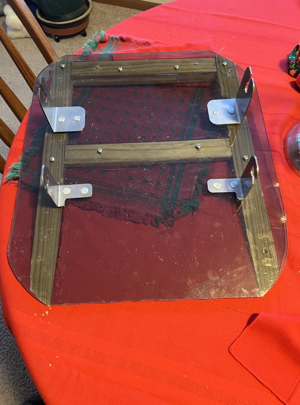

I decided to install an Airhead composting toilet in my boat. I wanted to be able to remove it (as I did the porti potty) to give more room to shower, or perhaps to use it in the future in another RV. So I built a separate platform to attach the Airhead to, and then the platform can be screwed down in the head. Since the boat lists when using the head while solo, or if we are both on that side of the boat, I angled the platform to counteract the listing. About 1 1/2" higher in the back. I embedded T-Nuts into the head floor to screw the platform to. I thought I had a photo of the vent fan setup as well, but wasn't there when I went to download the photos from my phone. I currently have a 4" Marinco Solar Vent, which is no longer recommended by Airhead, and my plans are to remove that Solar Vent and replace it with a 3" Marinco 500 Vent, as recommended by Airhead. But too cold in Wisconsin right now to do any fiberglass repair, so I instead made a spacer plate that attached to the inside of the solar vent to accept the airhead venthead.
Colby

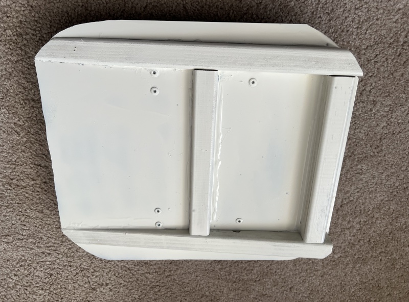

Photo of the base before painting. I used poly carbonate and some 2 x 2's.
Bottom of the base after painting.

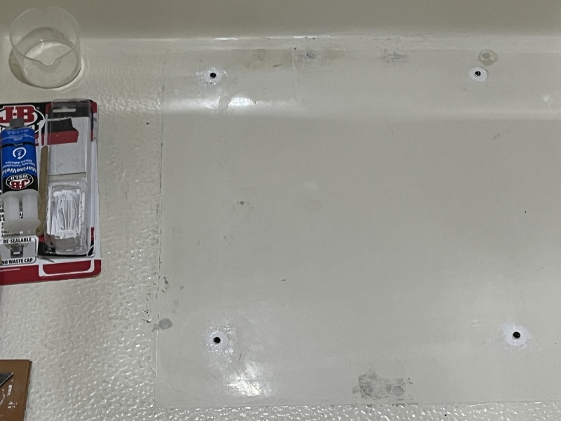

T-nuts embedded with marine epoxy into the head floor.

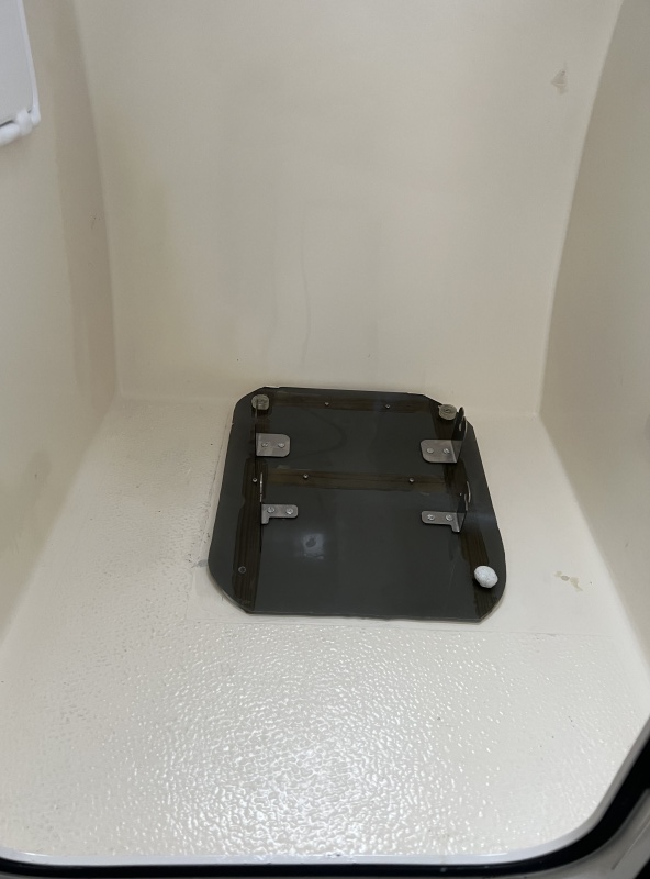

Platform installed in head.

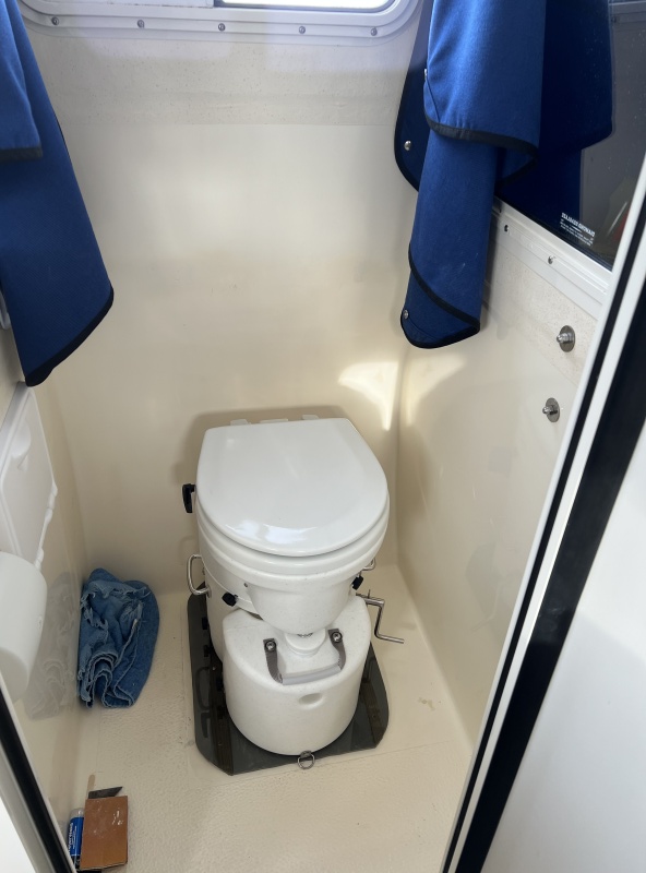

Airhead installed in head. Vent hose not hooked up yet. I'll have to take a few more photos....

Colby,
Great job on the head installation!
My AirHead originally had the small 12 VDC computer fan in the top of the vent line. Because I do not like to have any power on when I am not using the boat, I eliminated that and put the 4” solar Marinco fan in. There is the same vent on the bow hatch, bringing air in and the one over the head, is taking air out. That was based on feedback from several user groups. All has gone well after almost 4 years.

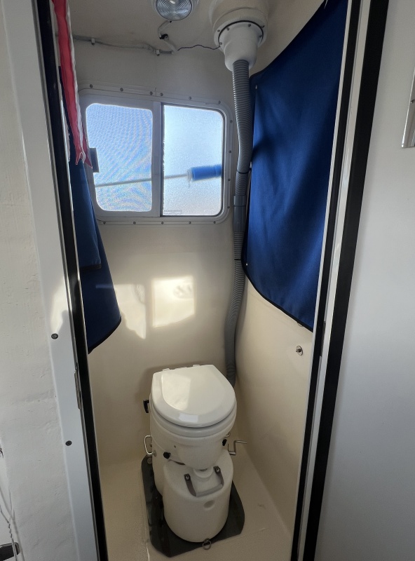

Here is a photo of the final installation:

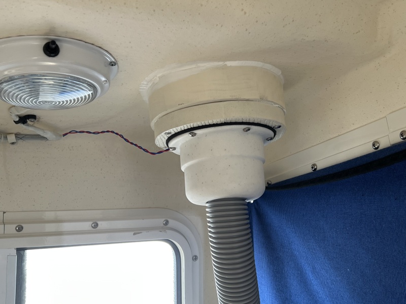

And this is a close up of the Airhead vent hose/head attached to my solar vent via a spacer plate.
