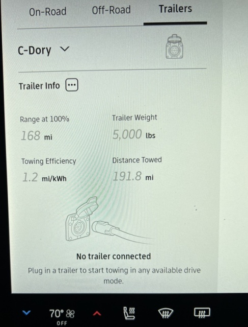

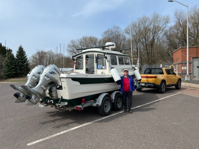

Veering away from racks and answering your sustainability question; we decided to move from diesel to an EV tow vehicle. With a year's experience with an EV car; we decided it is time to make the move to an EV truck--a Rivian R1T-- to tow our C-Dory 22. The R1T towing range gets us where we boat -- the WI Lake Superior south shore and the MN north shore.
This is the best towing vehicle we have used--for local towing. Local, for us, means 150 miles. The truck's towing capacity is 11,000 lb; supported by 835 hp, 908 lb-ft torque. Here is the spec for our towing, so far:
Chuck Olson
Obsession 2008, 22 Cruiser, Twin Honda 40hp
