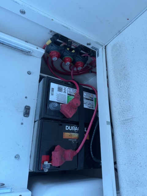

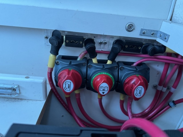

I ended up placing the start batteries (2X AGM gr 31) and main switches under the aft settee of the dinette. I built a tray behind the drawer and off the floor as high as I could so I知 not really loosing any storage there and it's very easy access.

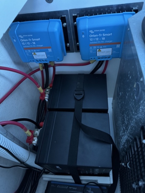

The house bank (2X Lifepo4 LiTime 100 AH) and Dc to Dc charger are located under the forward settee of the dinette behind the fridge.

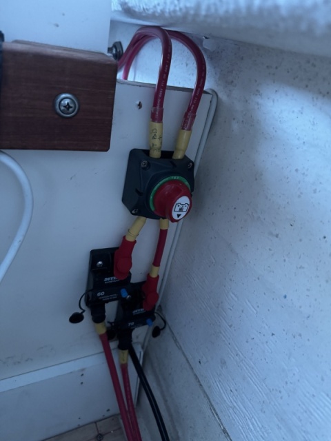

The house bank switch is just outside of it for easier/quicker access.
I have one breaker for the windlass and line hauler, the other breaker is for everything else.
