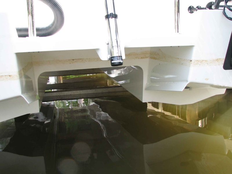

I did calculate the tonage for the Tom Cat: there are two peculars which apply: first is that the boat does not qualify as a multihull:"For the purposes of simplified measurements, twin hull and tri hull vessels are defined as only those which have no bouyant volume in the structure which connects the hulls together."
At rest, the Tom Cat 255 the wing deck under surface is under water when the boat is at rest or at low speeds.
The second issue, is that the Armstrong Brackets provide bouyancy when at rest, so that the boat's length becomes 27feet six inches rather than 25 feet 6 inches. This should be refected in the Master Builder's certificate.
The beam is 8' 6". The depth is 3' 9" and this calculates to 5 net tons.
The newer PDF forum does not allow as much fooling around with the numbers as did the interactive site. But it does show the tonnage in the upper right corner.

If a part of the boat is in the water, there is an assumption that it provides bouyancy. In my boat, the waterline is several inches above the bottom of the wing deck, the part immersed comes about 1/3 of the length of the hulls from the stern foreward. The part of the Armstrong brackets are also immersed, and would provide floatation or bouyance at rest. (The bouyancy can be at rest only, and not when at speed, as is the case of the Tom Cat 255. ) There does not have to be a calculation of the amount of bouyancy. See the photograph below which shows the waterline, and that the bridge or wing deck is submerged:
The Coast guard documentation site has changed as of Jan 1 2008. You used to fill out an interactive form and play around with the numbers to get the max, considering hull type and depth (not draft--the depth is measured from the top of the gunnel. In some vessels the volume of the deck house may be added if it is greater than the volume of the hull.)
The new web site has an interactive PDF document, which you can print out--and it is the form you submit to the Coast Guard. The documentation site is at:

This is an older thread but I have been thinking about the tonnage of the Tomcat. I came across the current version of the interactive form. I took it from the USCG site and posted it on my site as a resource.
http://www.commercialcaptains.com/Articles/USCG_Tonnage_CG_5397.pdf
The wing deck and Armstrong bracket clearly provide buoyancy. Based on the hull shape at rest, it makes sense the barge/box would be most accurate. Without factoring in the cabin, I come up with 7 tons. It would be interesting to measure the cabin and plug in the exact number to see if that increases the tonnage. The "principle structure" of the cabin would have the 6'6" figure if I interpret the form correctly.
Thoughts?
--Matt
Posts: 21378
PostPosted: Thu Aug 21, 2008 6:23 pm    Post subject: Reply with quote
Matt,
All that is necessary is that the vessel be more than 5 tons admeasured. I am using a Mac currently and it does not properly interact with the form--so I cannot say if the current forumula would differ from the 6 tons I got--but it makes no practical difference. The deck house--would be subject to some interputation--although it begins at the bottom of the wing deck, any "draft" would be from the top of the gunnel to the top of the cabin--more like 4.5 feet high, 9 feet long, and about 7.5 feet wide--then the foreward trunk cabin 1.5 feet high, 4 feet long and 6 feet wide. I doubt that this volume would exceed that of the hull--which is 27.5 feet long, 8.5 feet wide, and 3.8 feet deep)--some approximate numbers I came up with would be: 888 cubic feet of hull volume, (assuming the barge like hull. The deck house would only be approximately: 340 cubic feet--and thus not in excess of the volume of the hull). Remember that the hull is from the top of the gunnel, to the bottom of the deepest part of the hull--and much of this area, is well below the sink and table level in the interior of the cabin--all of that part counting as part of the hull, not the deck house.

Ah thanks...I read the definition of "overall depth" in the instructions document and it indeed is a measure from the top of the gunwale down. Based on the that the volume inside the cabin would not exceed that of the hull.
Thanks for the clarification!
