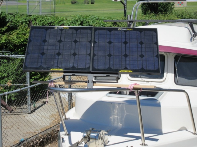

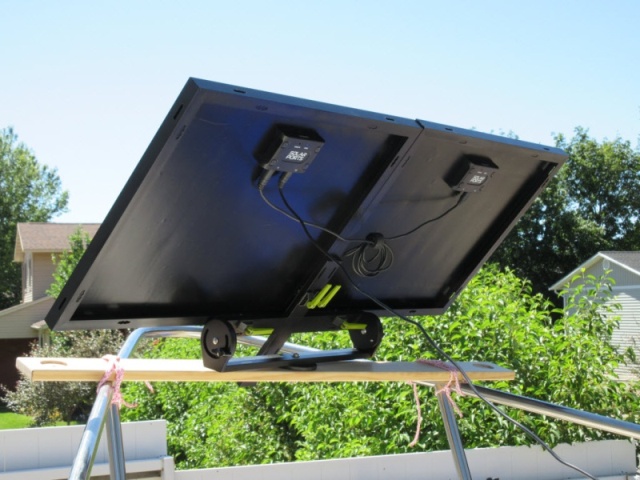

I've been experimenting with 4 Goal Zero portable panels that I take with me with the trailers or the boat. I have an Engel 45T Fridge. One panel will pretty much keep up with the fridge and two will keep the battery charged nicely. The only time I have to put all four out is when the weather gets bad. When I use them with the trailer they mount on a tripod so I can sit in the shade and move the panels to the sun. On the boat I have just been hanging them off of the boat some where. I made a board so I can put them on the bow and turn them at the sun. Of course at Lake Powell back in the backs of the canyons if your trying to hide from the sun there might be a small problem. You should be able to get enough time during the day to get the batteries topped off.
