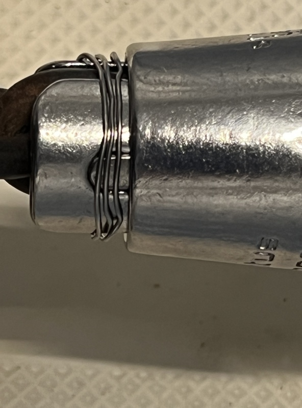

Resurrecting this thread with a question. After a discussion at the Hontoon gathering, and seeing the Mantus chain swivel, I decided to change my Lewmar swivel out for this robust monster. I am a little concerned about the pin that holds the chain in the swivel however. Seems like it wouldn't take much wear, before the pin could come out. Here is a photo of the swivel on my boat. I did put some safety wire around it for now, but don't expect the wire to stay on as nothing to keep it from slipping off towards the chain. The pictures on the Mantus instruction sheet appear to show part of the pin uncovered as well, but mine seems to have a little more of the pin showing. John, how's this compare with yours, and if anyone else has one, how's it compare? Colby

Did you use the oblong pin? The pin is stronger than the chain link. Mine has been working for years with no sign of wear. You can buy spare pins for 2 bucks. it's a great swivel no side lode.

Yes, I used the oblong pin that came with it. Just seems like too much is left showing beneath the collar. Colby

I don’t see any significant difference between the Mantus photo and your photo.
https://www.mantusmarine.com/mantus-swivel/
But then, I’m an old fart with glaucoma. I’ll get a picture soon of my connection.
I agree Mantus engineers have the oblong SS pin as the strongest link in the rode, as long as the bell and anchor connections are properly seized down with the provided SS wire. I suspect allowing owners to visually inspect the condition of the $2 oblong SS pin ends is a deliberate (and I think wise) choice. There is no way that pin can ‘back out’ if even a tiny amount of the bell housing prevents it.
Over the decades, I’ve noticed that the ‘last link’ galvanized G3 chain attachment to the high grade SS shackle or swivel gets worn and/ or corroded (two dissimilar metals immersed in salt water for many overnights will have that happen). So I hacksaw off the ‘last link’ every few seasons even if it looks OK. Maybe OC on my part.

Thanks John. I did use the cotter pin to lock the bell housing in position, and just used the SS safety wire to secure the bolt holding the anchor clamp. Tom called me and said he just took his apart to do some work and it still looked good after the time he has had it. He felt my pin was fine from the photos. So I guess I can stop worrying. Cool Colby
