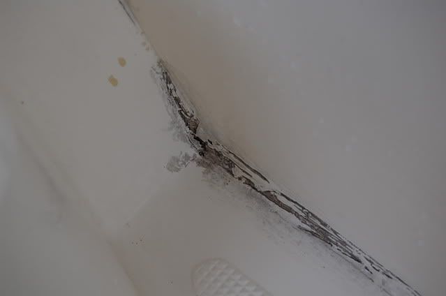

I'll get out on the boat on Friday and will try to take some photos and then post them over the weekend.

I just noticed this tread about water under the floor on 2007 22” CD’s. I have a 2007 and I’m now wondering if I have issues that I have to address. I never noticed whether I had this aft hole in the floor just before the bilge, but now I’m wondering if some if this bilge water I was finding after I drained, clean and wiped down the bilge is coming from under the floor and not just water that sloshed around from under the gas tanks.

I had talked to Fluid Marine just as they were being sold to Seasport. Seasport had no obligation to take over the warranty, so I had to fix it myself. They was another long topic on the warranty issue.
I ended up following the advice Fluid Marine gave me. I get my service done at Cook Engine, so I told them to cut a small access port on the vertical surface of the cockpit deck where it drops down about two inches and the fuel tank walls are. They borescoped it and found structural foam stringers, but no filler foam.
Then, they tilted the bow up and let it drain with a heater running on it for three days until all the water was out and the best I could tell it was dry. Then they epoxied the hole in the bilge corner. Last, they installed a plastic drain port to close the hole in the vertical surface.
It's been back in the water about a month now and I haven't had any more problems.
Reading back through this, I think Fluid Marine was trying to keep the back of the boat as light as possible. When installing the cockpit deck, that corner of the bilge probably got bashed on something, causing more than one boat to have the hole.
Since you can't see the hole, nobody notices until you vacuum the bilge complety dry and lo and behold, hey, where is that water coming from?

When I talked to Fluid Marine about this problem, they said there is very little clearance between the hull and the cockpit deck in the area between the fuel tanks. In fact, the deck is glassed to the hull there at the transom so there is no space between the deck and the hull.
Drilling a hole on the horizontal surface between the fuel tanks wouldn't get you much access as the hull is likely less than a quarter of an inch below the deck. That's why they told me to drill on the vertical surface where the cockpit deck goes down the two inches into the fuel tank area.
You can barely see the little access port they put there and they had a pretty good view into the void between the deck and the hull with a borescope. I'll get a picture next time I am down at the boat.

I have a little water under our floor on the rear, On the inside of the door at the bottom it was not sealed good, there is a little hole, a little water comes out there that tells me that water under the rear floor. It has been in the water for 3 months.
If you install a hoz. inspection plate let us know where you did it. When I get it out of the water in about 2 weeks I will pressure check it to see where the water got in at. But would like to have a inspection plate to look in there.
I had some under there last year, I found a little place that was not sealed good on the outside right of the door, I sealed it and have not had a problem until about 3 weeks ago.
