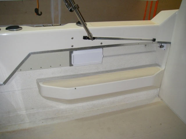

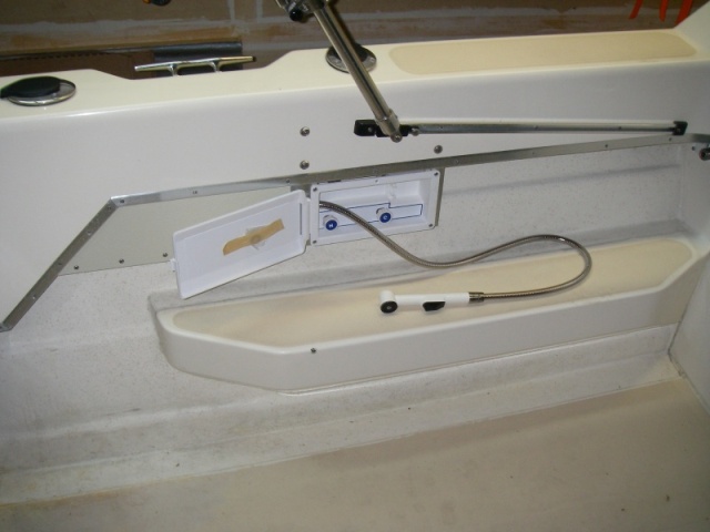

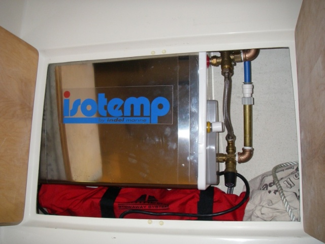

I also wanted hot water for washing dishes and showers so I bought the isotemp 4.2 gal electric water heater. Only 750 watts so it runs off of my yamaha 1000 watt gen or of course shore power. I just camped for a week at lake mead and it worked great. I have put hot/cold hand held shower in the cockpit and I have privacy curtain for my camper canvas so it is a bigger shower than I have at home. This water heater is extremly well insulated so when I leave a slip in the morning to go fishing I still have hot water at lunch time to wash up! See pics in my album.
PostPosted: Mon Apr 13, 2009 12:14 am    Post subject: Reply with quote
Nice Job, Bob!
4 gal 750 watt water heater
cockpit shower closed
cockpit shower opened

good job! Did you find a unit without the engine heat exchanger? Where was the best price? From what I could about $600 plus S & H.

thanks, it was a bit of work but worth it. I bought the water heater from west marine, it does come with heat exchanger hookup but did not use them with the outboard of course. Not to many choices with 750 watt/ 120 volt elements, and the flat shape helped in mounting.
