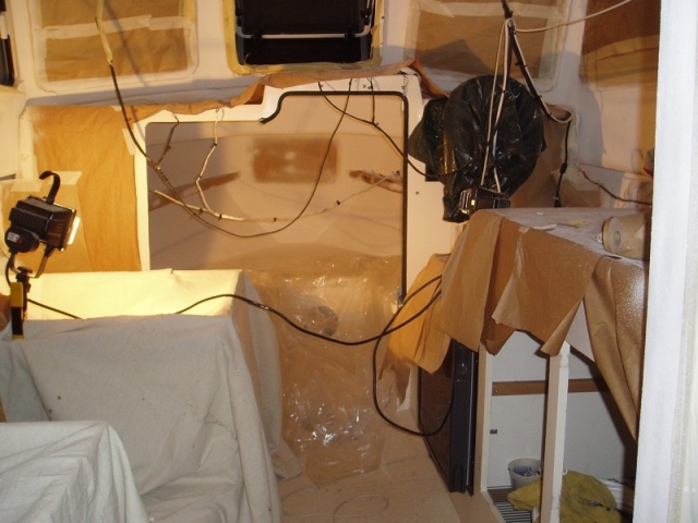

PostPosted: Thu Jan 27, 2011 2:53 pm    Post subject: Reply with quote
Well I don't have any pictures of the after. Here's one of the "during" photos. Shows just how much fun you have to look forward too.! Razz
Got any pics of how it looks now that it's completed? I think I'm gonna mask around the windows ~1/2" from the frames, following the radii as best as possible, and go to town. I'll then paint over the Delta and THEN pull the tape. Just a plan at this point, but I'm hoping it will at least look clean when done. I need a good project once the weather here warms up a bit.
Posts: 4673
PostPosted: Thu Jan 27, 2011 3:01 pm    Post subject: Reply with quote
Looks like fun...
...not. Wink
