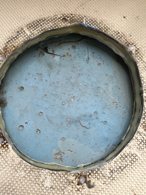

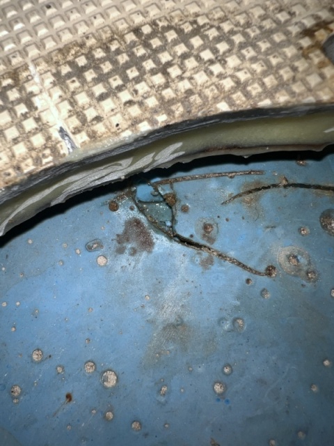

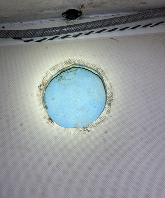

I bought this boat used, it already had two inspection ports when i bought it. 1 is right at the back of the cabin, as you walked through the door. The second is in the v-berth. I am in the process of removing the inspection ports and sealing them with epoxy. Can anyone can tell me what this blue stuff is? These first two pictures are from the v-birth inspection port, looking back towards the cabin/stern:

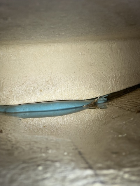

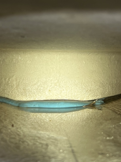

These next pictures are where a little concern arises. These are pictures of the cabin access port. With what appear to be the same blue material below it. You can see what looks like a few cut marks below the lip of the inspection port. I assume if they are cut marks they probably happened when cutting the hole for the inspection port.
I saw a liitle bit of moisture in those cut marks and am concerned there is rotten balsa beneath. I picked at the marks a little but was never able to see balsa or confirm that they were deep enough to get down to balsa (if there is any down there?).
So really my two questions are:
1. What is that blue stuff?
2. What is below the blue stuff?
Thanks

PostPosted: Mon Sep 25, 2023 7:01 pm    Post subject: Reply with quote
I have a 2006 Cape Cruiser, so we have the same boat.
I had water under the cabin floor and so I cut an inspection port close to the cabin door. I was stunned to see some sort of purple-red material that was cracked and had water in the cracks, similar to what you see - only yours appears to be blue.
Maybe others that know for sure can chime in, but I think it is leftover resin that was poured into the void under the floor, before the floor was installed.
I think that this material was poured on top of the inner hull, perhaps for adhesion or extra rigidity of the floor, but that is just a guess. I don't think there is balsa under it, but just poured on top of the inner glass hull layer.
I solved (for the most part) the water ingress into this area by re-sealing the cockpit floor to aft cabin bulkhead seam. I also removed all the plastic plugs in the cockpit floor and the ones under the door on the inside of the cabin, and filling the holes with epoxy and glass.
I would not seal up the inspection ports, as they allow access to vacuum out any water that may find it's way into the area, and also allows a flow of air under to floor to aid in drying, if opened and a small fan blowing into one of the holes.
Chris

PostPosted: Mon Sep 25, 2023 7:17 pm    Post subject: Reply with quote
Chris
Interesting yours is purple/red. I looked back through most of the photos on this thread and couldn’t find any pictures like mine. It feels very tough whatever it is.
As for the sealing, I meant that I was sealing up the exposed balsa from the inspection port cuts. The inspection ports are for sure staying 🙂

PostPosted: Tue Sep 26, 2023 12:56 am    Post subject: Reply with quote
I looked for pictures also, yours are the first I have seen that are similar to what mine looks like. I will try and take a couple of pics and will post them on this thread. It does feel like very tough material.
Apologies for the misunderstanding, the pics seem to show the inspection hole edges already sealed, so I thought you meant the entire port hole....
Chris
