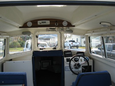

Wow, Minnow, what a nice enclosure you have for the upper shelf! Did you build it yourself? Do you have a template of the face profile you would be willing to share with an envious fellow C-Brat?

Wayne, if I still had the template, it probably wouldn't do you much good. There's just too much variation from boat to boat.
It's easy to make your own. I started with cardboard scribed to the roof-line, then refined it in 1/4" plywood. This was then transferred to 3/4" plywood, the door cut out, and then teak veneer was applied. The back and edges around the door were also veneered.
The veneer was finished with a coat of cherry stain to redden it up to match existing. Two coats of teak oil finished off.
