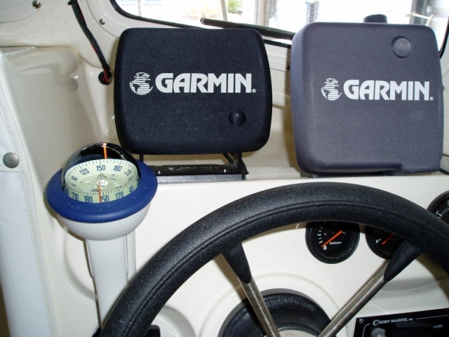

One thing to be really careful about in a small boat is the influence of metallic, magnetic or electronic instruments on your compass. We all move "stuff" around the boat fairly frequently.
The fluxgate compass will auto compensate if you do a couple of very slow 360 turns, but a classic magnetic compass will not. All goes down the tubes when you move something anyway.
Try putting you cell phone within 1 ft of the compass and see what happens..
On CD22 you can probably forget any dreams of 1 degree accuracy. Repeatability maybe.

I wouldn't leave home without a compass. I find for a smaller boat the Iris 100 works great. I have no interference from electronics, and it can be lifted out of the flush mount and used as a hand bearing compass, or stored until needed. It costs about $100.

When outfitting "Sea Shift", Les installed a compass that can be "quick released" from its' base mount and then it becomes a hand held compass. This allows me to carry it out into the cockpit, where I can be certain that I am clear of any thing of interference that would cause compass deviation.

Dave, You want to compensate the compass/draw deviation tables with the compass in its usual position on the dash. Even in the cockpit, there can be magnetic influences from metal objects--plus there is the problem of how to line the compass up fore and aft accurately. You will be steering with the compass from the location at the helm.
