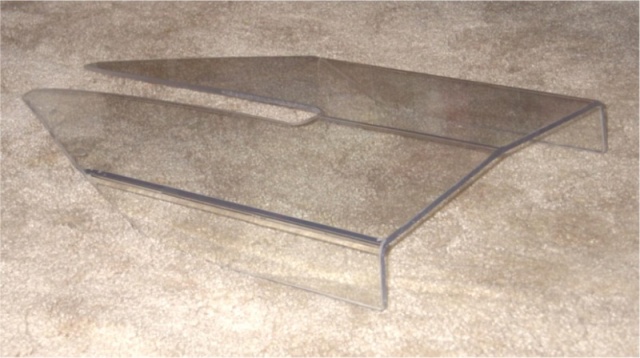

PostPosted: Mon Dec 13, 2004 10:42 pm    Post subject: Reply with quote
Jon -
Behold the first, the last, the only PermaDork™ in the world. Do you want me to mail it, or wait'll next month and deliver it personal?
The material is polycarbonate. I'm not saying it's tough, but if the rig you drive at work has a clear plastic barrier between you and the bad guys, chances are it is made from the same stuff. Bulletproof? No. But it will hoist C-Lou's scrawny little butt up a couple notches.
There are no mounting holes drilled in it. You can transfer the holes you already have in the cav plate and drill it yourself. For the trial, you don't need a whole bunch of screws, but use at least two per side with one pair pretty far back on the cav plate. It fits real good on my Honda 130, and Les told me a while back that it has the same lower unit as the 75 and 90.
You're gonna be a dork if you try it, though. Just one small step from nerd.

PostPosted: Mon Dec 13, 2004 11:08 pm    Post subject: Reply with quote
Wow Mike, that's amazing! Heck yeah I'll try the Permadork out, although it doesn't look dorky at all. As a matter of fact, that thing looks very hi-tech.
As much as I would like to slap that deal on there right now, I'll be patient and get it at the SBS. I'm sure others would like to look at your talented work.
Way cool Mike Thumbs Up

PostPosted: Sat Jan 22, 2005 1:29 am    Post subject: Reply with quote
Well Mike, I took her out on glassy Lake Crescent today and this is what happened:
Running in a straight line at different speeds ( 0 to 26 kts.), the Permadork performed great. When I got the boat trimmed out at around 21 kts., the boat was like riding on air. Great smooth ride!
When turning in circles (left and right turns), I think this is what impressed me the most. I started with a moderate turn running at 20 kts and trimmed it up a bit. The boat turned like my car, unbelievable! So, I got brave and went faster and faster while turning in circles. Still, the prop never washed out. Finally, I put the hammer down and cranked her pretty tight and the prop still wouldn't wash out. The boat tracked really smooth in all the turns. There wasn't any weird felling like that SE300 hydrofoil I recently removed.
I'm sold. The only thing I noticed is that it flexes quite a bit, but it didn't seem to hurt the performance much.
Thanks again Mike, I had a ball trying that thing out. It really works.

PostPosted: Sat Jan 22, 2005 7:24 pm    Post subject: Reply with quote
FDO, Jon! That's too cool.
Absolutely, ship the thing out to anyone who wants it. What someone ought to do is come up with a low-profile clamp gizmo of some sort so they can try it without drilling the holes. You already had holes in your A/V plate, and matched them to the Dork, so no problem. But others might get so many holes in the plate that their motor sinks.
To tell you the truth, I think the ability to flex is a very good thing. It kind of softens the stress on the cast aluminum A/V plate, which will not flex much even if it needs to. To make a guaranteed one out of that polycarbonate (same stuff as Lexan), it would have to be molded to shape to keep it from eventually breaking at the cuts, holes and bends. I bet the original PermaDork would make it a season or two, though.
From what Bill tells me, the genuine article is made out of 1/4" aluminum. Not much flex there, and a good bump from backing the trailer into a tree could cost a big check to Honda. Whatever you do, don't stand on the thing like the guy in the ad does. Cynthia could stand on it alright, but keep your butt off.
If a guy wanted to get rich, he could make the things out of 10ga stainless and custom fit them to each size/brand of motor to spread the attachment stress out. Of course, the people who bought them would have to be rich, too.
Did you notice any straight line steering differences? Like wanting to pull to one side or making it harder to turn one way than the other? As sensitive as those outboards are to a little tweak of the rudder skeg, I would think that the big wings of the foil could cause some problems if they were not identical in depth and area. There's no way I bent that piece of plastic junk perfectly, so maybe it isn't that critical. If all you boating pros keep raving about the performance, I see a stainless steel one on a Honda 130 somewhere in the future. Better stock up on toilet paper now, because I got a feeling the pulp mill prices are going to go up!
Glad to be able to return some of your help. For us working stiffs, $104 is a lot for an experiment. Especially when you probably have that much tied up in junked out hydrofoils that didn't work as wanted.
OK - I won't make fun of you if you buy one of them dorky lookin' PermaTrims.
