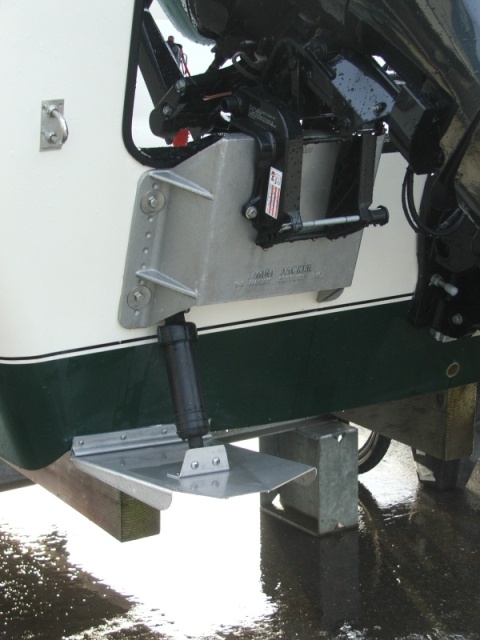

We had the factory install the Bennett M120 Sport Tabs. The M120's are 10x12. After doing research on this site, it seemed that the M120's were the trim tabs of choice for many C-Brats. They work really well on our boat. However, we also had them install a Mini-Jacker kicker bracket in order for the kicker to clear the trim tabs. It made for a very nice and clean installation.
Sorry, the pic is so big but I don't know how to resize.

PostPosted: Thu Oct 25, 2007 2:19 pm    Post subject: Reply with quote
Peter
That is a Nice Bracket!!

PostPosted: Thu Oct 25, 2007 3:41 pm    Post subject: Reply with quote
Peter
Nice clean looking installation. Wondering if your M120 sport tabs came with the Joy stick or toggle type switches? And if you got the joy stick contol switch how do you like it? When I went to the Bennett site it looks like all thier new trim tabs come with a joy stick control now, but was not able to find and technical specs or pictures.
