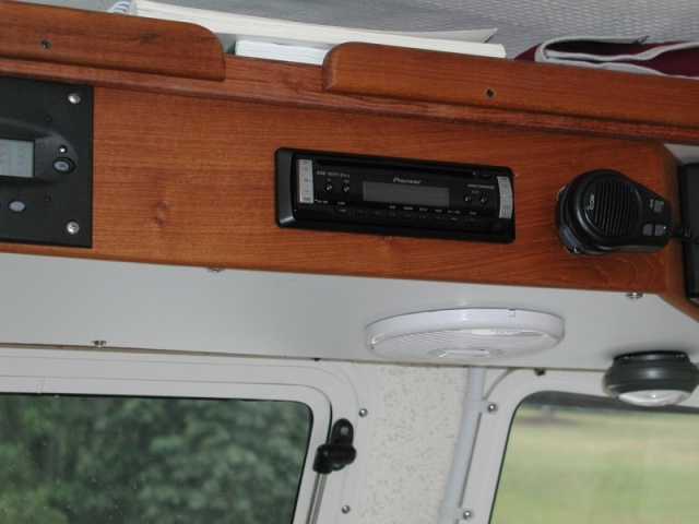

I have some photos in my album. I made a template, but because I used
3/4" brazillian cherry, I found that I had to relieve the backside considerably.
That 's because the pilot house roof curves down towards the bow of the
boat right over the shelf. In other words, the cut is not 90 deg to the
face, it drops back significantly.
I also specifically did not try to achieve a perfect fit. If you are trying for a
perfect fit, then any imperfections are going to show. Leave a 1/8" gap, and
no one can tell if the gap varies by a 1/32" here and there. It works well.
I needed a gap in order to allow the opening to drop down anyhow.
One switch is for turning off the radio, but leaving the "memory"
wire with power. I did this because the radio display is lit up all the time
if you do not. The other switch turns the radio display to a "night light"
level. The third spot was for an aux iPod input, but it did not work well.
I ended up buying a better one from West Marine and mounting it behind
one of the speakers.
Mike

On the Comfy Dory, I used a piece of pine because the grain matched somewhat the laminate material on the cabinets and then stained and varnished it. All I wanted to put on that shelf behind the facing was the radio/CD and to leave the rest of the space for the coiled up GPS cable and our hats.(Both the coiled cable and the hats would launch out of the shelf after running at cruising speed (20 mph) for a short while or moving through rough inlet waters) I hinged the face piece vertically about 1/3 of the way in from the port side and fastened the starboard side with 3 screws into the edge of the shelf.
Make a template before you cut the wood. Measure the width and then take about 5-7 perpendicular, evenly spaced measurements to the bottom edge of the shelf from the cabin roof. Make a paper or cardboard template and then test for fit. You can continue to adjust the template until it suits your eye and then cut your board.
Good Luck...Tad
Good Luck...Tad
You'll have to post pics of your vessel and modifications once you get a photo album setup (PM Tyboo).
I planned to make a template and your idea sounds good. If I take enough measurements I should be able to get a decent cardboard template.
