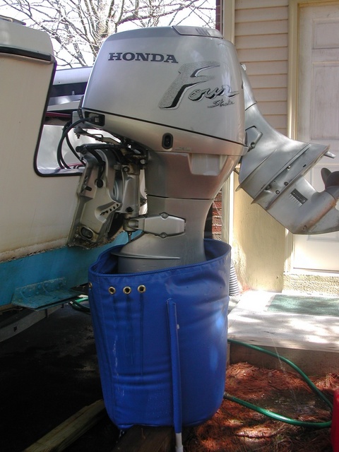

PostPosted: Thu Jun 10, 2010 6:41 pm    Post subject: Reply with quote
Captains Cat wrote:
Steve, we use one of these for flushing. Works in/out of the water...
If any of you use these flushing bags, make sure you store them in a rodent proof bag. Got mine out about two weeks ago to demo the Honda 35 on the 16 Angler that Dragonfly bought and found it totally "moused". Holes all over the place. It's a heavily rubberized plasticlike fabric. Totally ruined.

PostPosted: Fri Jun 11, 2010 1:33 pm    Post subject: Reply with quote
I've got permatrims on my Suzi 115's and I have a flushing bag, which I don't use anymore. It's kind of tight to get it in the bag, plus on my boat and trailer you have to put the bag on a platform to get it high enough. Then it is a pain to get it off and or wait for it to drain. I'm back to using ear muffs when out of the water and the flushing port on the side in the water. You can run the motor while you are using the port as it does not flush the water pump and would cook the impeller.

PostPosted: Fri Jun 11, 2010 4:17 pm    Post subject: Reply with quote
The flushing bags are a great way to go, but with the Permatrim it's
going to be necessary to have Quality make up a special sizing, which
I think they will do w/o a problem, but probably for a additional cost.
They are pretty good folks and I don't think it would be a big deal.
(ref, Suzy 90 & 115).
I've been using their bags for years and would have a larger bag
made up if I wasn't at a point where I'll probably be putting 3rd Byte
up for sale.

PostPosted: Sun Jun 13, 2010 3:48 am    Post subject: Fresh water flush Reply with quote
How about using a 55 gal plastic drum cut down to fit your height etc. A 30 gal could be used on smaller engines.
I have a 55 gal and will cut it down for my 200 hp Honda.
