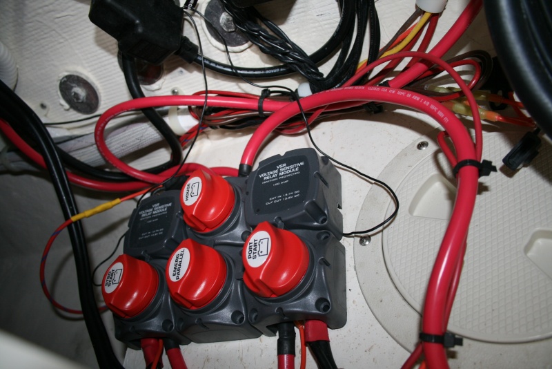

Hopefully I have understood your question correctly. I have a three batteries - two starting and one house (located beneath the forward dinette seat) hooked up to a three battery VSR cluster. The VSR is located in the transom, assessilbe through the port lazarette (see photo).
You are correct that to switch on the batteries, I turn the house and starting batteries ON and leave the Parallel switch OFF (except in emergeny).
Can't seem to get the knack of 'embedding' the photo - but should be able to clink on this link. http://www.c-brats.com/modules.php?set_albumName=album492&id=IMG_8412&op=modload&name=gallery&file=index&include=view_photo.php
Mark

So in looking at this photo it looks like you added an extra VSR and battery switch. Do you have a wiring diagram of how you wired it up? I was thinking of that but if the second VSR and switch aren't needed then I would prefer not to purchase them as they are spendy indeed.

ACH! Never mind. I forgot that you had twin outboards VS my single inboard/outboard. Thus you have 1 battery for each motor plus your House.
What I'm trying to do is to run 2 starter batteries for my main engine plus 2 house batteries. So 1 battery for the engine is primary and 1 is secondary but stays charged via a VSR. I think I figured out what I need. If I use the BEP 714-100A for the starting batteries and then get another VSR and battery switch I should be able to make it so that I can charge both starter batteries plus the House batteries. Hmmm... This'll be a little tricky. Well back to cleaning the bilge out so I can drop the new motor in.
