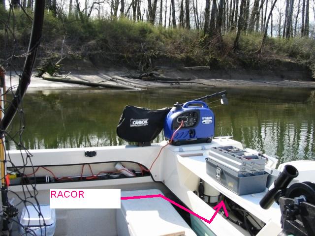

No, but you can see how to make one or I'll help you out as much as possible.
There's a specific site where there are tons of ideas on how to work with the Honda EU 2000 (and EU 1000, therefore) HERE
Also, there are pictures of my set up starting HERE and for the following several photos.

Sea Wolf Joe and I where fiddling around with generator gas caps the would allow you to hook up to the main fuel tank for extended running. I purchased a Honda fitting and installed it into a gas cap from a Harmony mower, this allows one to unhook the fuel line from the outboard and hook it to the generator....aint field tested it yet, should work.

Joe, did you ever figure out where your air leak was coming from ? Was it the cap itself ? If I copy your setup, do you think that I'll be able to lift fuel from my Racor up to my Yamaha w/o starving her.

Joe, if we can't talk you into making the fuel suction system for us......is there any chance you would be willing to make a specific listing of ALL items needed to make this project. Maybe even best place to find the items, Home Depot, etc. I know I'm not the only one interested in this project. Your photos are great by the way.

One issue with the fuel transfer--is the the pump/gravity feed will not pull fuel over a foot or so on the Honda--and I think would not work well in the TC 255. We put the 6 gallon tank on the swim step or on the aft seat and the generator on the aft swim step. (see the Thataway album).
