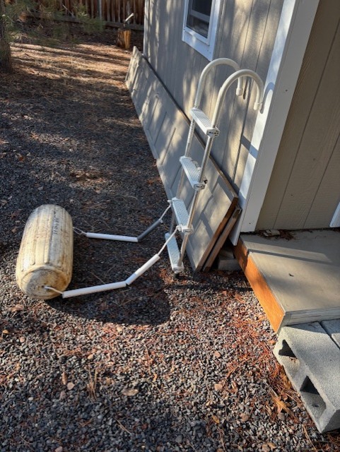

I cobbled up a kayak stabilizer that attaches to a folding boarding ladder. Took a couple of lines that hooked onto the ladder on one end and a big fender on the other. I ran the lines inside of some PVC pipe so the fender stands off of the boat. It works great..I just stuck a pic in the B. C album
Ken

Hey Ken, Is this the one. Hope I did this right.
