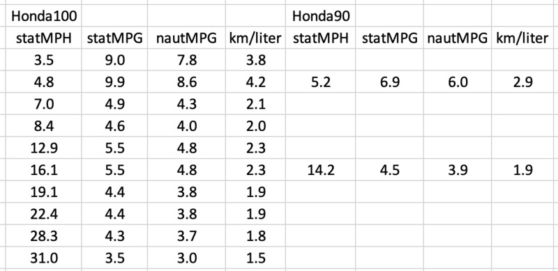

CDfolks; for the sake of international and nautical folks...here is a reinterpretation of my data, including the estimates for the 90. I only did two serious estimates based on using an external tank, warming things up, moving with no/low tides or significant wind, and placing the external tank on an accurate scale. I used 6.07 lb/gallon as density for gasoline.
Again, remember that this is:
1) just my boat, relatively lightly loaded, just me and no gas in the main tanks
2) I tried to keep under low wind and tide
3) I expect less mpg when boat is well loaded
I'd be thrilled to see similar data from other folks. If you have it, you can use your multifunction display to adjust rpm/speed, etc. You really don't need to know exactly.

I have logged an hour or two on my boat and found your numbers to be perfectly reasonable. Thanks for sharing them. As somebody noted up in the thread, 17-18 mph does seem to be the best cruising speed, in regards to efficiency, for my boat too. I have an idea why....maybe because of a sweet spot in cam grind, conservative rpms, and a light throttle setting resulting in a more efficient curve. Pure speculation on my part.....
