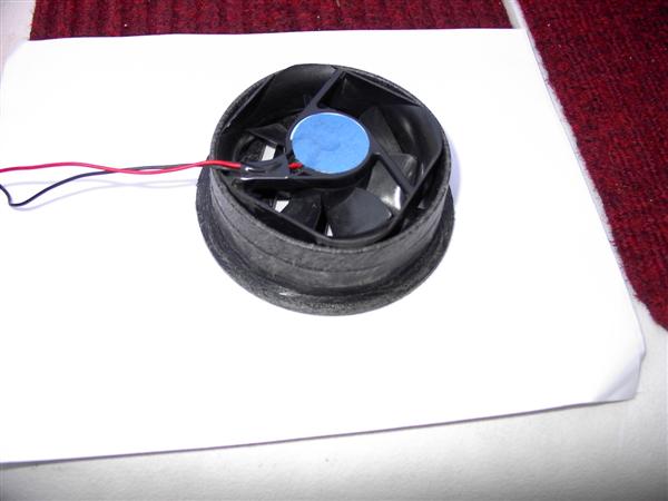

Another approach to aid the flow would be to go to the ends of your ducts and install booster fans to help pull the air to the outlets.
The small computer fans come in s myriad of different sizes and can be adapted to all kinds of uses.
Here's a photo of one I put in a duct to push air up a 4 ft tube:
The fan frame has been ground off to round it off to fit inside the plastic drain cap which is to be used as a vent grille.

Joe, good idea on the push/pull fan-in-the-tube trick! I once did something like that to vent battery gases overboard in an enclosed battery compartment that was INSIDE the cabin -- couldn't believe the mfr got away with that for years. I used a 3" RV sewer hose (new of course...) and found a suitable computer fan that fit just right, worked great, no more fumes. Should work with the Wallas heater -- unless it is sensitive to TOO MUCH air flow as well. Heck, maybe just the one register output will work fine, might do that for a year before making mods -- got plenty of other mods on my list that continues to grow and grow and grow.
