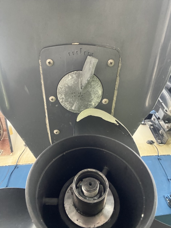

I think most folks think in terms of where the tail of the tab is pointing in reference to port or starboard.
This image above is of my outboard's trim tab, looking up from the ground. As you can see it's set 3 points to starboard. In this position, it helps to counteract the RH props tendency to torque the outboard to starboard. The tab is pushing the outboard to port when in fast flowing water. Ie, on plane. When I'm at fast cruise, the torque on my outboard from the prop is countered by the tab. Thereby making no difference in pressure needed to steer right or left.
I had a .5L autopilot pump on my 22's 115. It would occasionally stall as it tried to correct for heading. (Pump moved the motor to slow, so kept moving it until hard over, and then would stall.)
I think you are on the right track to adjust the tab in increments while on the water, running at a planing speed you normally run at. Once you get it set to where your steering requires the same amount of pressure to turn right or left, then run your autopilot and see what happens. You also want to insure your hydraulics don't have any air in the system, and that all your hoses are kink free. Colby
