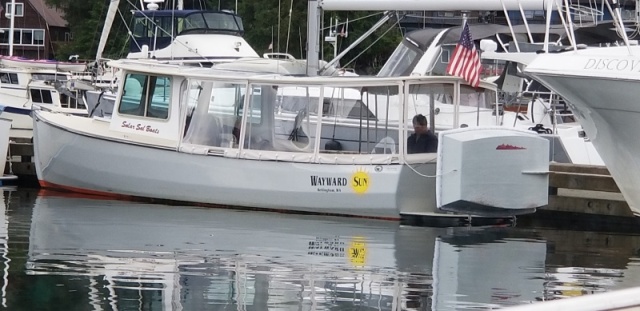

Here's the boat we saw in Auke Bay last July, which appears to be a practical (albeit slow) electric cruiser. They made the trip from Bellingham to Ketchikan in 20 days, roughly double the time it took us. Alex told me they could run continuously during the day at 5 knots using power from their solar panels. Faster than that or in low light conditions ate into their available battery power.
Link to Devlin's site that includes more detail.
https://devlinboat.com/solar-sal-27-the-latest-launch-from-our-shop/
