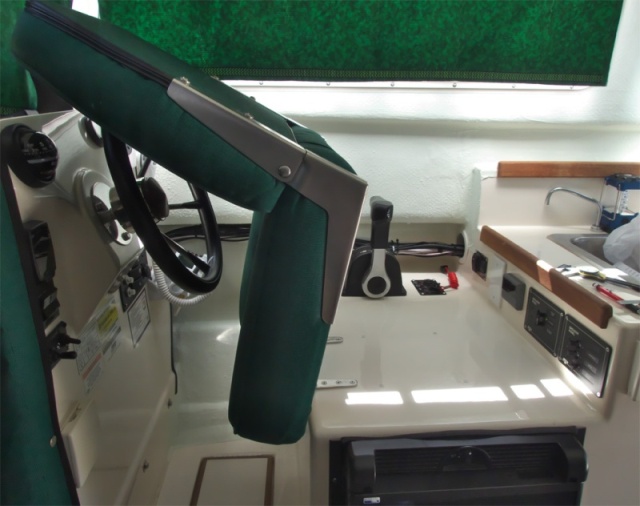

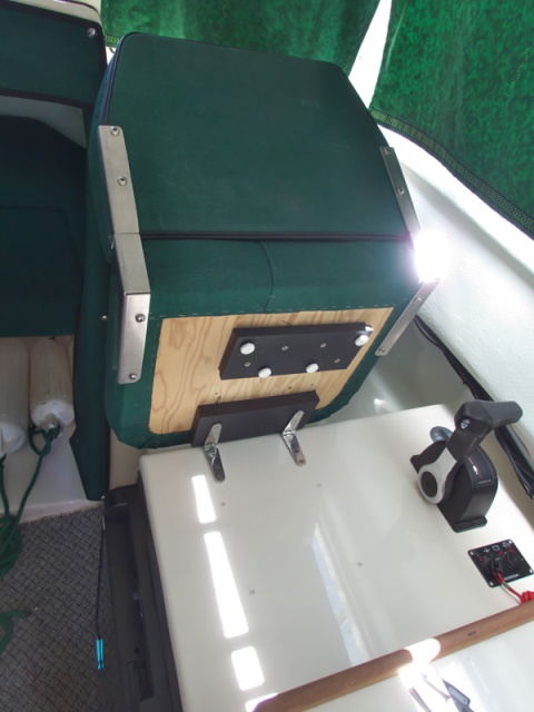

localboy wrote:
Also I unscrewed the captain’s helm seat and replaced the four bolts with two S/S hinges on the front an rubber furniture feet on the rear. That way when at anchor or dock we can flip it up and have more “counter space”. I use a small nylon strap with a snap on our window frame to stop it from accidentally falling and it just sits over the helm wheel fine. KISS.
I did the same thing to my helm seat, except mine rests on the helm and there is no need to restrain the seat in the forward position (it's over center).
