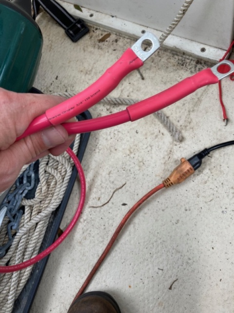

It took me about a day and a half between the family responsibilities, (kids need to eat I guess), several trips to the store, and a little over $1,000. which was mostly 2 new batteries, cable, a new battery selector and some tools.

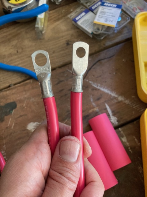

I built all new battery cables, had to replace the ends of my charging cables, one of may battery boxes and replaced the perko battery selector with a BlueSea 4 position switch. All terminals are properly sized now.

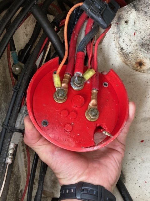

I use that Perko selector a lot to go from battery 1 to battery 2 through all. It has been getting hung up on all recently. I wonder if the switch malfunctioned and dead shorted the batteries? The switch did melt where battery one is hooked up. I haven't used my volt meter for anything other than measuring voltage since my electronics class in high school 22 years ago but isn't there a way for me to use it to check for a short across the battery switch? Theres no other way the battery wires got crossed and there was no way they were externally shorted except for possibly the switch. A surge from the charger doesn't make sense because they too are fused and the charger was actually showing a fault at battery 1. So maybe it was a combination, maybe the switch dead shorted the batteries though a loose connection at battery 1's post? I'll go figure out how to test for a short across that switch
Now that I think about it though isn't that the Perko's job? to combine the batteries? It isn't hookeld up to any negative source to short? Would it even be possible for the Perko to cause a dead short? Yea may never know ut this sure is fun.

You are correct that there should be no negative side cable to the Perko switch. I have had these switches fail. But even if they were combining, both charged batteries, I would not expect that degree of heating....If the one battery had shorted internally, and then the other battery was switched, allowing full flow of the amperage to that shorted battery. If that had happened, I would not expect normal voltages in both batteries--as you found...
