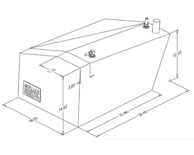

I just got an email from Northwest Marine (C-Dory) saying they had given me incorrect information. The correct information is
They are a plastic Moeller brand which can be purchased from Fisheries Supply online. The part numbers are FT 2339 and FT 2340.

Those tanks are are shown on the web site diagrams page 33 and 34.
This is basically a catalogue of the Moeller tanks.
If Fisheries Supply does not have them in stock--there might be a way to buy directly and have them shipped. Amazon seems to have a number of Moeller tanks with Moeller as the supplier.

Interesting that Moeller doesn't appear to make any other left/right tank combinations other than the two 23 gal. tanks for the C-Dory 22. I know they used to because my '99 has a Moeller FT2536 25 gal starboard tank, but they don't list it on their website. My port tank was replaced with a 23 gal. Waylander before I owned the boat.
If someone was looking for larger tanks, here's a 30 gal. tank that fits under the splash well... https://www.plastic-mart.com/tech_drawings/moeller/ft3199-1-r2_(032631).pdf
I can't get the link to include all of the text above so you'll have to add the pdf portion manually in your browser URL header.
However, it doesn't come in left/right versions and so doesn't make efficient use of the same space (lacks the angled side to accommodate the upward flare of the hull). New plumbing would have to be fitted, but now you have 60 gal. total capacity. The biggest problem is that because the tanks are longer the bilge pump would have to be mounted in front of the drain hole, instead of to the side. The only way to get more room would be to raise the tanks.
