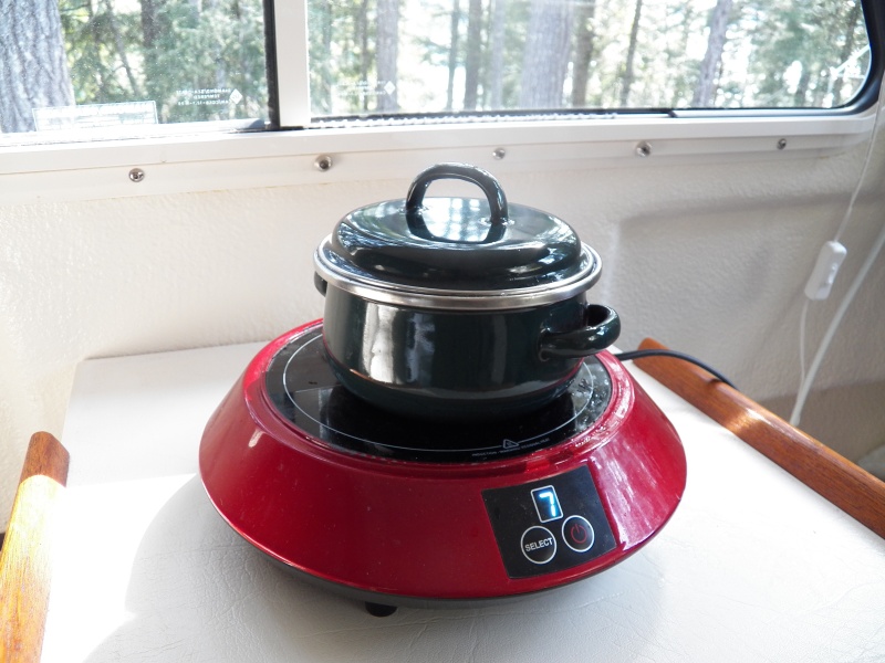

Mark- This photo?
(Caption below)
"This is a $45 induction cooker connected to a 800W modified sine wave inverter.
The lowest setting is a nice simmer and the highest setting could fry.
It doesn't trip the inverter.
It seems to be about a quick as a microwave and no open flame."

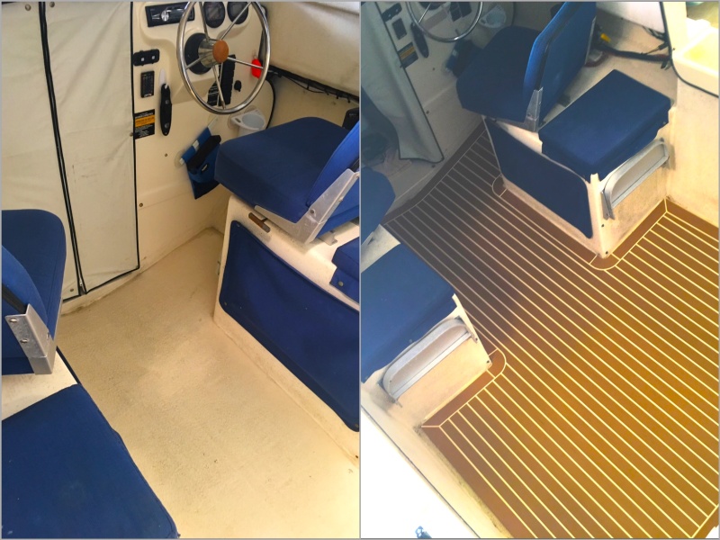

It looks as if you have room on the back of the seat pedestals to put in the burner and sink as shown. I would first find a sink which will fit in the area. See how much room is below it--to get a good drain overboard--and keep the thru hull above the water line. You may also want to measure how much room is available for the water tank. There is a very small 12 volt pump, by Jabsco which fits in line, and then you don't have the issue of putting in a manual pump--which will be problematic for your layout.
If you want manual, then a Whale foot activated pump may be best. These can be cabinet or floor mounted.
