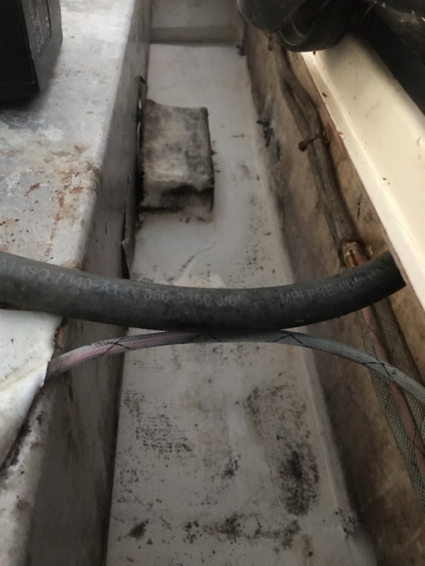

Everything actually looked pretty clean, once I pressure washed the mold and mildew off. I'll try to put a few more photos in C-Traveler's photo album later. The tank is not fastened down any way, but does have some "bumper stoppers" behind it to keep it from sliding back. The interesting thing is, there is a good 6 to 8" of space between the rear of the fuel tank, and the bulkhead. Has anyone tried putting in access plates to this space to use for storage of things like say a spare paddle, cleaning brush, boat hook, or even fishing poles? Sure seems like it would be a good space to store such items. Colby

PostPosted: Wed Nov 11, 2020 11:10 pm    Post subject: Reply with quote
This is a photo of that space I was referring to at the back of the fuel tank.

Colby, did you set all of the screws in epoxy plugs, and take care of any core issues while you had it apart?
I don't know how easy it would be to access that area aft of the tank. I believe in my boat that aft bulkhead in the fuel compartment goes all of the way from bottom to top of the space.
Posts: 4967
PostPosted: Thu Nov 12, 2020 1:21 pm    Post subject: Reply with quote
Fortunately the only core issues I could see was with the side steps and I cleaned those out and filled in with epoxy or fiberglass. I’ll take care of the screw holes before putting it back together but a quick look earlier showed them to be ok. There is a small cutout in that back bulkhead for the fuel hose and some wiring along with the drain hole center bottom. Too bad it wouldn’t be easy to put a long rectangular hatch over that area tho for additional storage.

I agree with you Colby on there being some water near the cabin bulkhead. I can keep my aft bilge dry with the boat on the trailer, and slant back on.
A good reason not to have another hatch over the aft end of the tank, is that it would leak, just like the others do! I find plenty of storage aft of the cockpit under the splash well--I have a fender board there, and at least 6 "shoe boxes" full of spares, parts, extra electrical adaptors. Then I have two boxes on each side in the bulge (I have dry deck on the bottom of all of these compartments.
Posts: 4967
PostPosted: Thu Nov 12, 2020 10:20 pm    Post subject: Reply with quote
I'm kind of thinking that also, about more leaking thru compartments. The other problem is the shape of the cockpit floor right there near the aft edge. There is about two thinner inches where the floor is over the "rim" holding it up. Then it is much thicker. As I think about it more, I suspect it would affect the structural strength of the floor to put a hatch in this area as well. Next place to put an opening or hatch, would be in that short bulkhead between the fuel tank and the aft compartments. But access thru those would be a pain. Where is your water tank located? Mine is under the splash well. Although I do have some room on top of it to put some stuff. I don't have quite as much room in the other area you mention, as I placed a small 3 gal fuel tank on the port side of the bilge to use as a spare tank with no ethanol (not sure I really need it), and the on the starboard side the trim tab pump and oil reservoir take up some space pretty much right in the middle. (Lousy placement. Maybe I should look at moving it.) Really just hate seeing that open space behind the tank, and not being able to use it. Laughing Colby
