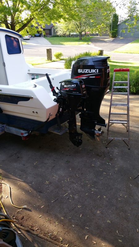

The kicker is installed:

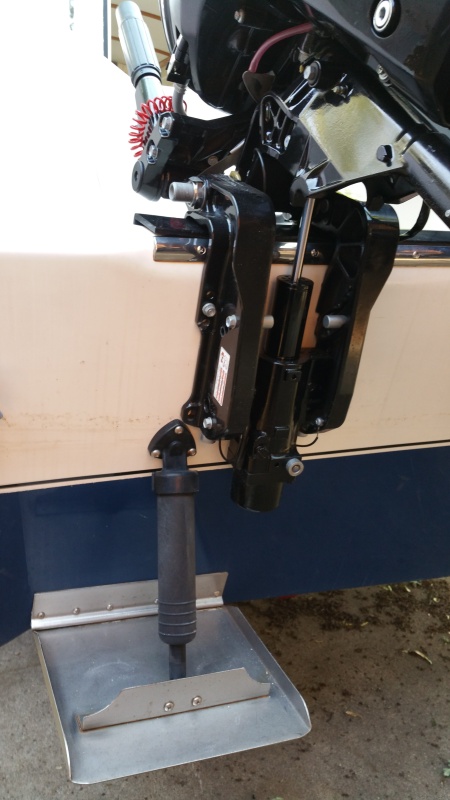

Well, we got the boat, and the first morning after we got it home, I ordered the Suzuki DF9.9BTHX, fuel injected, high thrust, power tilt, electric start, tiller. I ordered it from onlineoutboards and it arrived at my doorstep in exactly 2 days from when I placed the order - outstanding. The new motor was in great condition, and my son and I lifted it up into a trial position, and I found a location where I could mount it on the transom without a bracket. With the highest tilt stop setting, the motor is just about exactly vertical when all the way down, and it clears aft of the trim tab by about an inch. When the trim tab is all the way up, it is about 1mm under the anti ventilation plate on the kicker. I also installed a the removable steering link bar. No bends were necessary, and there were very good mount points available for the ball fittings on each motor. I also through-bolted the kicker, and sealed the core in the holes I drilled with epoxy.
The electric is wired into the system right where the main motor's connections are. For fuel, this boat already had a sierra water separating fuel filter inside the starboard lazarette. I bought some new fuel line, a new squeze bulb, a new quick-fitting for the motor connection, and the brass fittings and shutoff valve. I installed this into the unused "out" port on the fuel filter, and ran it through the same passages as the fuel lines for the main, along the motor well, and over to the kicker. Now, I have a quick disconnect right at the motor, and I have the original fuel line and 3gal gas tank that came with the motor. I can easily swap the kicker to use the portable tank or the main tanks in the boat.
We had it out on the river yesterday and I started the break-in procedure, and I'm about 3 hours into it, out of 10. So, I haven't had it up to full throttle yet, but ran it for a couple hours at 3/4 throttle, and it easily pushes this boat 6-7kt. Full throttle should give a little more, which is really max displacement speed for this size of a boat. It's really the perfect match for the boat, and it the kicker looks quite nice sitting next to its matching bigger brother DF175. I'm quite happy with how this project turned out.
So, with this setup I can run the kicker from the cockpit using the tiller, but I can also steer from the helm, or use my autopilot to steer the kicker. And it's so nice that this motor has electric AND pull start. It has "batteryless" EFI, and a small alternator. So, if I ran the batteries dead accidentally, I can still fire up the kicker, which will start charging the batteries, and eventually be able to start the main. So nice.
Thanks for all your input guys. I posted a bunch of pics of the install in my album in the "Kicker Installation" sub album.
Mathias

PostPosted: Fri May 22, 2015 4:43 pm    Post subject: Reply with quote
Nice!
Is the kicker clamped or bolted on?
Brent Barrett
mathias999us
Joined: 28 Mar 2015
Posts: 52
City/Region: Forest Lake
State or Province: MN
Vessel Name: Venture Bound
Photos: Venture Bound
PostPosted: Fri May 22, 2015 4:44 pm    Post subject: Reply with quote
Thanks Brent. This kicker is both clamped and bolted. I used the regular clamps, and then also through-bolted it, as per the Suzuki installation instructions that came with it.
Mathias

PostPosted: Fri May 22, 2015 4:52 pm    Post subject: Reply with quote
Here's a pic where you can see the port through-transom bolt head for the mount:

We have a 25, so similar. We used a "hi thrust" 9.9 Tohatsu. It's the same engine but with a four blade, "hi thrust" prop which I just bought and swapped out. Pushes the boat enough for our uses; limited trolling and a get safe engine should the main die. I also ran it off the main tank; just another line off the one filter/water separator. We do not have the ability to control rpm's from the helm, but we use a tie rod to control steering via the main.
My one regret is I used a pre-made mount (Mini-Jacker) to raise the kicker and move it to stern to clear the starboard trim tab. If I had to do it again, I'd have one custom made to move the engine back another few inches; it clears the tab by a mere 1" now.
PostPosted: Sat May 23, 2015 2:33 pm    Post subject: Reply with quote
When I switched from a Honda 8 to a Merc 5 (much smaller engine beyond just the 3 hp difference) the leg didn't clear my trim tabs as it did with the Honda. I also have a Mini Jacker mount. I considered a couple of options, one was to re-mount the Mini Jacker with a spacer between the mounting flanges and the transom, but I ended up with a simpler way, which is that I was able to use some fiberglass board at the point where the engine clamps to the Mini Jacker to move the engine back around 3/4" or so, which did the trick.
The latter may not be desirable or workable on a larger engine (or you may not be looking to change anything anyway), but figured I'd mention it.

That is a good, simple idea. When we first had the engine mounted it cleared the tab, until the engine was engaged and under torque. That pushed it forward and it vibrated against the tab something awful. Sounded like the entire boat would vibrate apart. I just adjusted it back one trim hole; problem solved.
