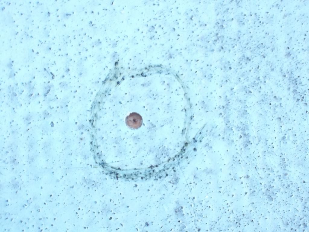

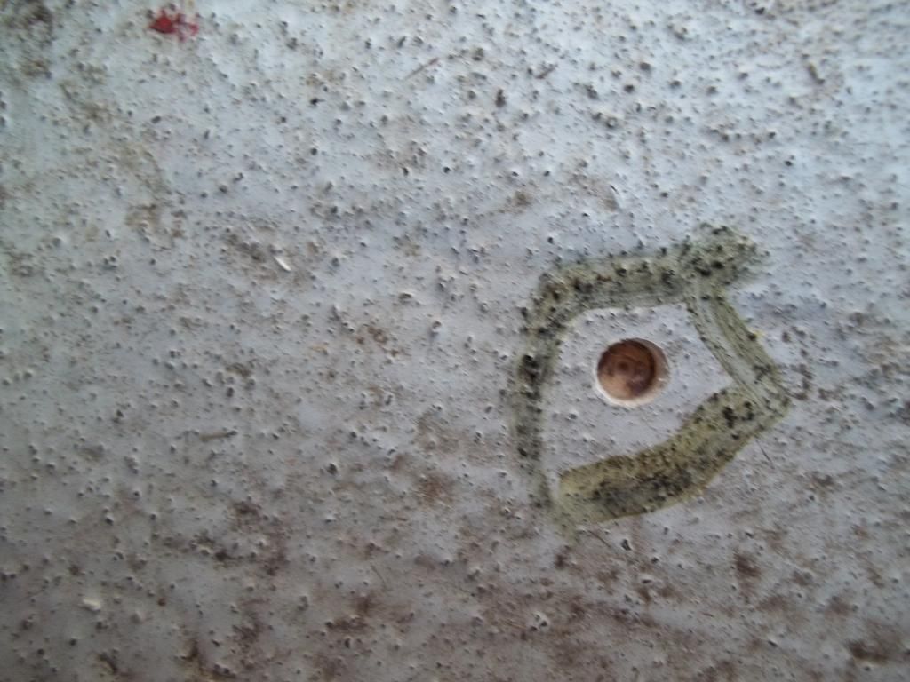

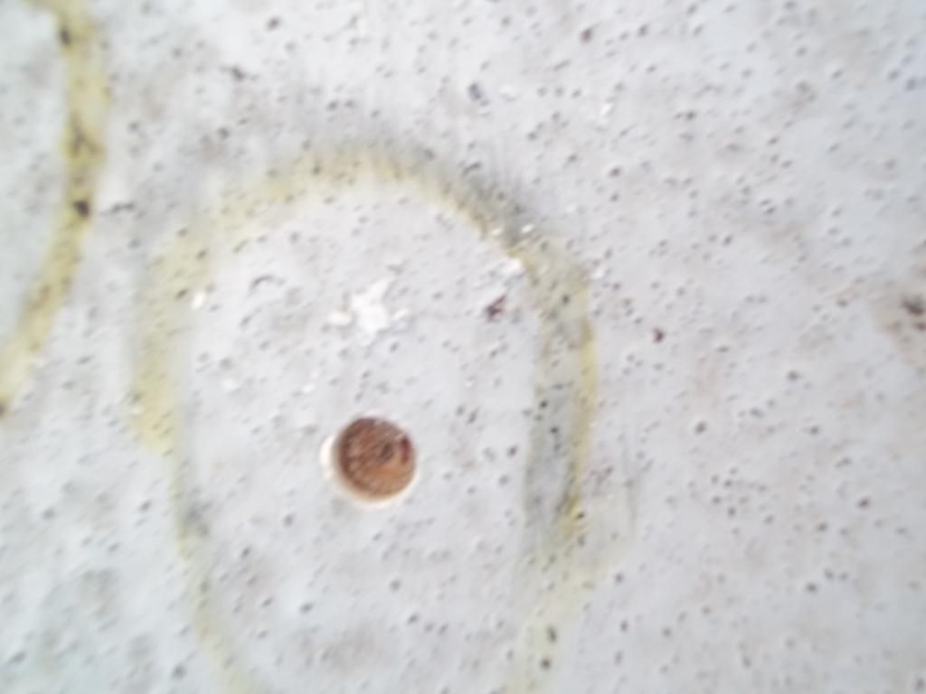

I brought my boat home from the marina early this morning a drilled 9 core samples with a 3/8" drill about 3/8 of an inch deep.
I may add that these pictures are not the best.

I checked the wood shavings from every hole, all were dry and a yellowish white. They felt and looked good. Today was very hot and I wasn't wearing my hiking boots, I was in my bare feet and really couldn't feel the soft spots like I had felt them before. I did feel some flex in the hull when I shifted my weight up and down but I think that was the trailer bunks flexing on their own. All looks good and thanks everyone for the great responses and information . Tug
PostPosted: Mon Jun 16, 2014 2:16 pm    Post subject: Reply with quote
Well that looks like good news! I have noticed that I oftentimes feel "false soft spots" if I walk on decks with something like tennis shoes on, as opposed to bare or stocking feet which don't cause that.
Well at least now you know for sure. Hard to beat a core sample.
I'm thinking about whether I would want to put a small piece of cloth over those holes or if just thickened epoxy would be enough. I guess that as I think about it, I normally end up covering those holes up - either with a fitting or a backing plate, or etc. Probably 3/8" is okay with just a plug of epoxy, but.... what does anyone else think?
The other factor I'm thinking of is that you don't have any undercut to "lock" the epoxy in place from cracking (around the perimeter of the hole). I guess I would have to consult my handy-dandy free WEST Systems guide to see what it said. Perhaps with a machined hole it is not a problem at all.
What I would do for sure would be to wet out the hole with neat (unfilled) epoxy first, then fill it the rest of the way with thickened epoxy.
Glad you have a nice, dry core!
