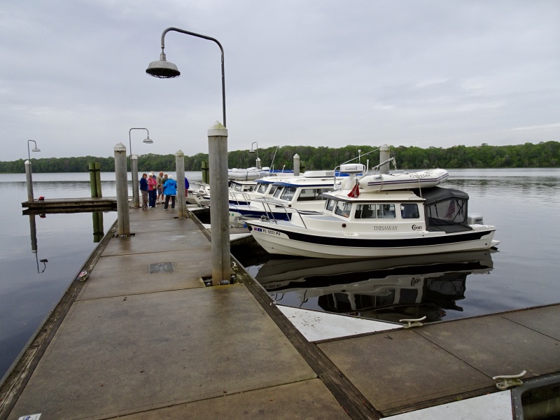

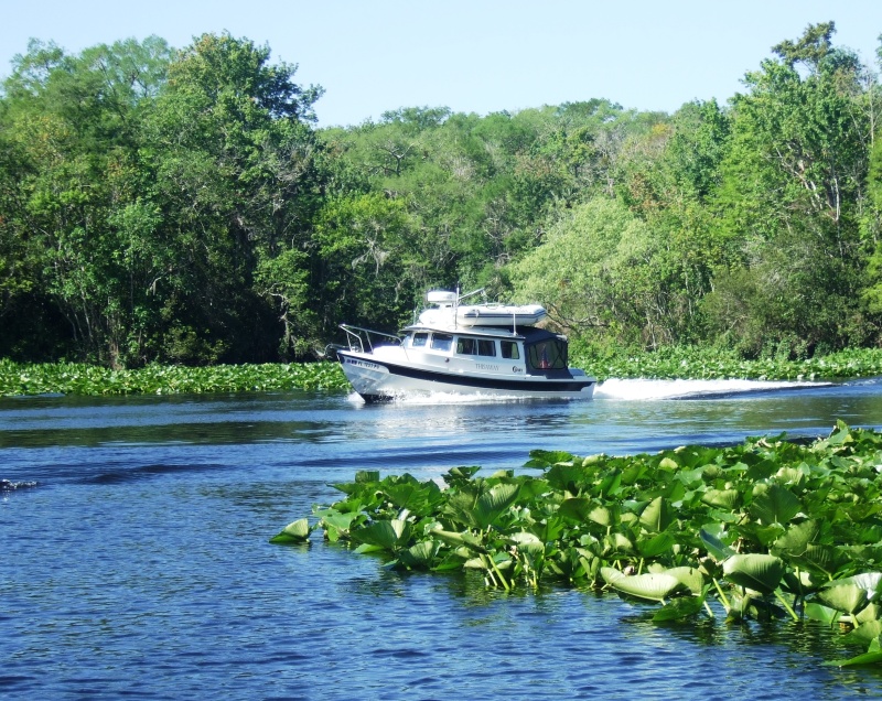

Some time has gone by and we have used the davit for several years--it is now improved, and is a very easy operation, can be done by one person--but slightly easier with two. No heavy lifting:
Below are 3 different views of Thisaway, with the dinghy on top, and davit holding a little of the weight--so no weight on the Bimini bows.
[img]http://www.c-brats.com/albums/Thataway/DSC01575.jpg
[/img]
These last two photos show the final secret of success--a way of lifting, which gets the dinghy up above the roof, and allows for an easy swing onto the pilot house roof.
This is a "spreader bar. It is a 3/4" sq aluminum tubing, with a 5/8" dowel epoxied in the center. This keeps the bar stiff and it does not bend with the weight. To achieve slightly better balance, the dinghy Torqeedo motor lower unit i left in the bow of the inflatable (tied in place.) We start with the dinghy in the water, and attach the spreader bar to the "D" rings (safety straps for the crew to hang onto)--these D rings can be glued to any inflatable--on the inside.) The last photo shows the Caribiner Ring which latches into the D Ring. I then settle with one foot on the deck, and the right leg on the cabin top--behind the davit--this gives me a good advantage to pull with two hands--left above the davit and the right beyond the jam cleat. We pull the dinghy until "two blocked", then swing it over the back, pivoting the aft pontoons over the Bimini, and up against the anchor light stanchion of the Radar arch. The bow then is held up by the davit. The dinghy is held in place with lines form the hand rails. Just as easy as some electrical davits we have owned on larger boats.
