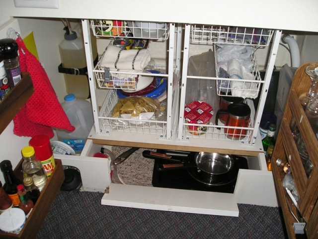

PostPosted: Tue Nov 27, 2012 3:14 pm    Post subject: Reply with quote
Don't remember if the 25 has the center support between the doors under the galley or not. If it does, it can be removed (sawed out) and a matching piece of starboard (same color as front of galley) affixed to one of them that would have to be closed first when both of them are closed. Doesn't alter the look if you do a careful fit.
I did it on my TC and it gives great access to the under counter space, even without taking sink out.
PostPosted: Tue Nov 27, 2012 3:44 pm    Post subject: Reply with quote
Too late to edit but here's a picture of the 25 under galley..
Apparently early 25's had no center support but later added one. I still believe it could be cut out as on my TC255. See above post. Without that post, it's a lot more accessable. The little door added at the bottom helps too!Thumbs Up
