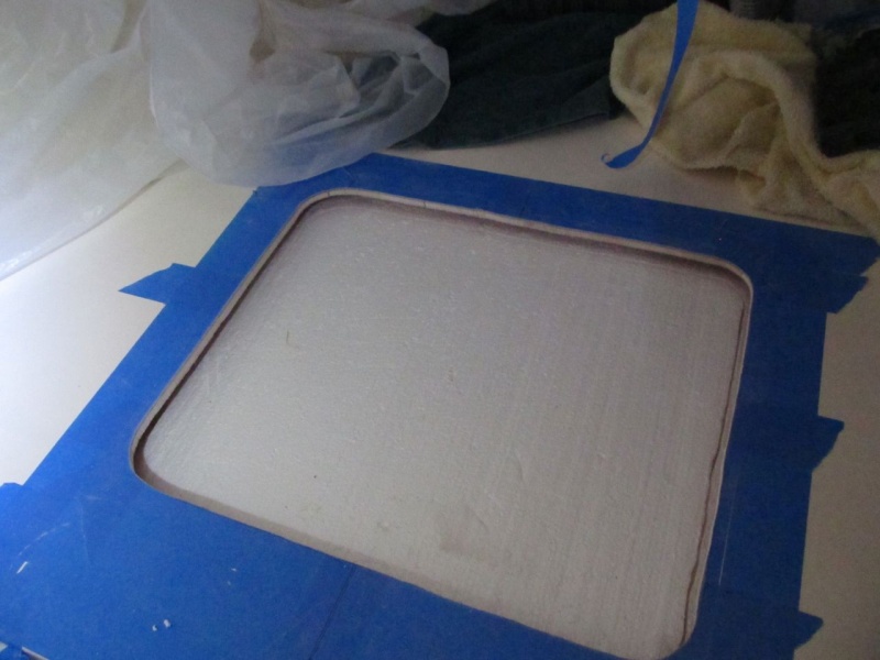

PostPosted: Mon Feb 22, 2016 10:51 pm    Post subject: Reply with quote
By the way, this is what the foam looked like in mine. It was massive blocks of expanded polystyrene (the white "bead" type; not the expanded/foamed in place type). You can see where I have started to saw a "line" around the perimeter - the blocks were much too large to come out otherwise.
These were a bear to remove, but the hull was completely clean (as soon as I finished chasing "beads" around with the vacuum).

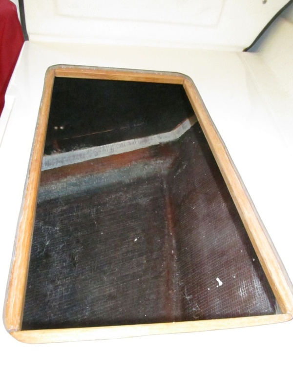

PostPosted: Sun Sep 25, 2016 9:01 am    Post subject: Storage trim ring Reply with quote
This photo shows the formed, aluminum frame, that allowed the cover board to be flush with the top as well as gave it a more finished look.
