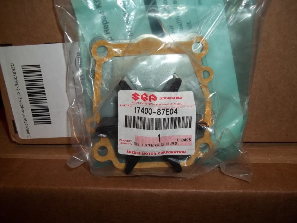

I just got my Water Pump Repair Kit from Brown's Point Marine, was less than $50.00. I bought the kit just in case i needed the seal also.
