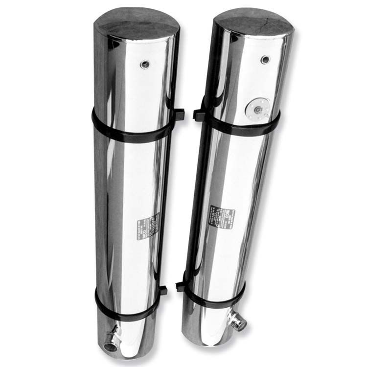

PostPosted: Tue Nov 08, 2011 12:01 pm    Post subject: Reply with quote
These!
Tug
Capital Sea
Joined: 16 Dec 2007
Posts: 425
City/Region: Olympia
Vessel Name: Capital Sea
Photos: Capital Sea
PostPosted: Tue Nov 08, 2011 1:09 pm    Post subject: Reply with quote
Those look nice and also expensive and being pipe shaped are a less efficient use of limited space. The tanks my old boat had were made of the same plastic used for the main tanks on my Cdory. They could be mounted in or below the storage shelves on both sides of the cockpit of a 22.

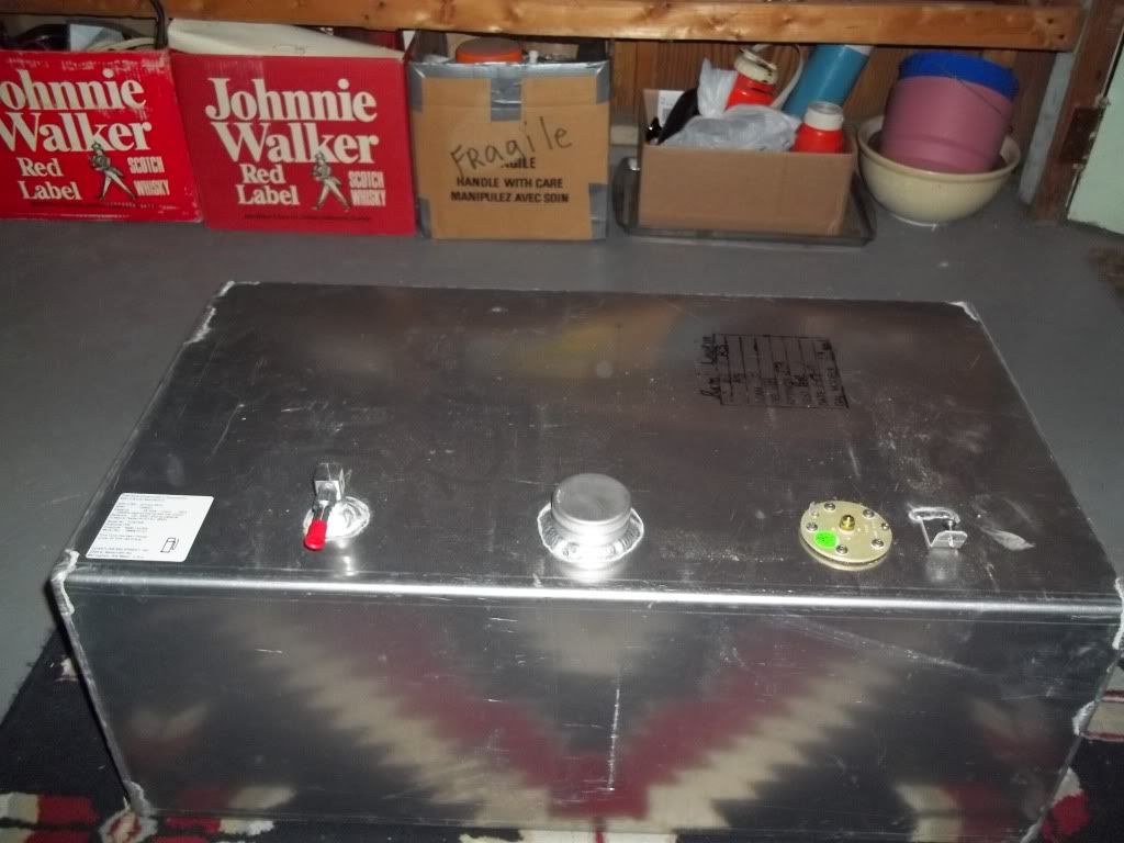

I found this 29 gallon gas tank thru a search that some C-Brat member had made: I ordered them thru Tom at " Coastline Equipment Inc " which Dave ( oldgrowth ) had recommended. Ordered them with a : Vented Gas Cap ( fill right at the tank ). electric sender unit. and with a gas fill connector which includes a gas pick-up tube that lays on the bottom of the gas tank and runs towards the stern of the gas tank so i will be able to draw up the most amount of gas in the tank while underway.

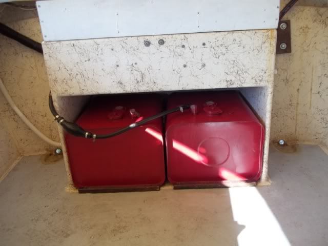

This will replace these two ( 1987 ) 12 gallon gas tanks that have broken down and left me stranded twice.
Wanted to install gas gunnel tanks but the templet ( dimensions from Kevin's tank's ) that i made out of cardboard didn't seem to fit my hull. This new tank will probably fit my needs, if not there are always jerry cans...Tug

Just received my Gas Tank from Coastline Equipment..very nice.
Here's a closer look at the sender..any idea's what wire goes where..nothing is marked. I suspect the bracket with the screw to the right of the sender is it ground and the ground wire is fastened to something on the deck..that leaves three more connectors on the sender itself. Is the centre connecter in the center of the bolt circle ( positive )..I'm not sure which of the two left is the negative and the last one i have no idea. Tug
Posts: 21468
PostPosted: Mon Jan 30, 2012 4:39 pm    Post subject: Reply with quote
Center to the gauge plus. The one with the stud on it--to gauge negative. Generally there can be any one of the other tabs or screws which would go to vessel bonding. (not to battery negative).
However you have created a situation which is a bit away from the standard practice. That is you have a tank which is filled in a non self bailing cockpit. Thus fuel fumes will linger in the cockpit and potentially into the cabin. Gasoline fumes are denser than air and will pool in the cockpit. This is why the gas fill is outboard and any vapors should drain overboard and avoid an explosion hazard.
Portable tanks should be filled outside of the boat (although I realize that they are often filled in the boat.)
Tug

PostPosted: Mon Jan 30, 2012 7:49 pm    Post subject: Reply with quote
Bob. i think what your saying is...the center connector on the sender goes to the " S " connector on the gas gauge.
The bolt with the stud and star washer on the outer circle. ( 3 o'clock position ). goes to the ground on the gas gauge.
The bolt with the tab on the outer circle ( 10 o'clock position ) is not used?
The welded bracket on the tank ( with screw attached ). that is located a few inches away from the sender just grounds to the deck.
I have the instructions for the Teleflex Gas gauge but they are written in Greek .. Question
The original tanks were the same way in that they vented into the cockpit also, not ideal but that is how the original tanks were. Thanks Tug
